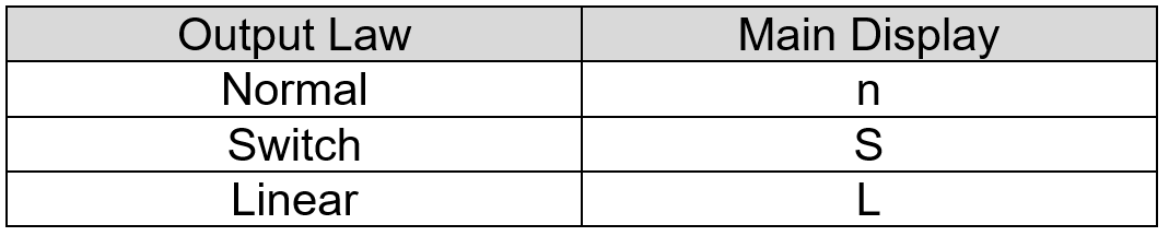

Three dimmer laws are available, which can be selected per channel.
Select ‘Law’ mode using the ‘Mode’ button. Using the ‘Up & Down’ Arrows select the channel required, or ‘A’ for all channels. Press ‘Enter’ to confirm. Now select the law you require, again using the ‘Up & Down’ Arrows and press ‘Enter’ to confirm and return to the channel selection.
Note that if the law is set to Switch, the switch-point can be set in the ‘Topset’ menu.
