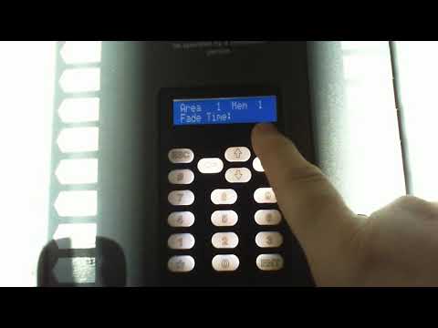

Press the ENT key to confirm the memory selection. The screen shows:
Area xx Mem xx
Fade Time: xx
The Area and Mem fields are for information only. The cursor appears in the Fade Time field.
Use the numeric keypad or cursor keys to adjust the fade time as required (1 - 60 seconds).
Press the ENT key to save the fade time to the memory.
The dimmer will then grab the current output levels for the selected area and store them in the selected memory.
The screen will briefly show a confirmation, and then return to the Record Memory screen.
