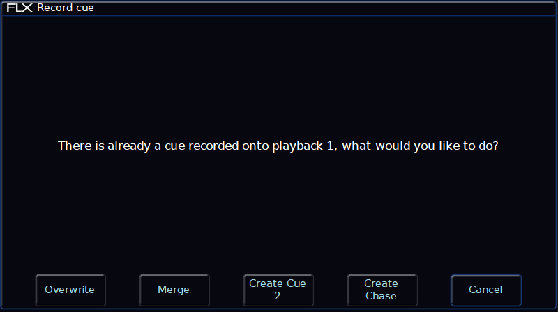

When you program multiple cues onto a playback, rather than this playback behaving as a cue stack, instead it can become a chase. A chase simply means the cues in the playback will automatically run one after the other in sequence, rather than pressing a go button to advance through them. If you go to record a second cue onto a playback, you will receive the popup shown. This allows you to choose "Create Chase", to create the second cue of your chase. You can then create another lighting state, record this to your playback you chose to become a chase, and this will be stored as the third cue of the chase. You will not receive a popup again, as the console now knows you are building a chase.

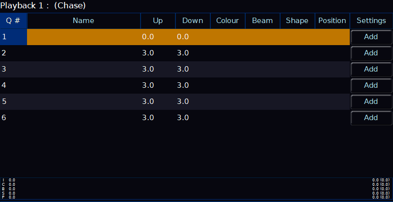

When you record cues onto a playback behaving as a chase, you can view it in the Cues window, just like any other playback. You can do this by holding View, and tapping your chase's button. You will notice this playback has (Chase) shown at the top.
Once you have programmed your chase, by recording multiple cues onto the playback, you can then raise your chase's playback fader. The chase will begin to run, at 60 BPM (beats per minute) by default. The button of your chase, will be a tap tempo, allowing you to tap twice or more to set the speed of the chase. Useful to tap along to the beat of a song, and get your chase quickly synchronised.
