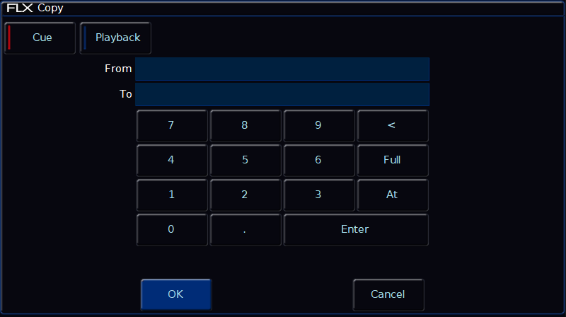

To copy one playback to another playback, press the Copy button. Then, tap the flashing button of the playback you wish to copy, and then tap the flashing button you wish this playback to be copied to.
Alternatively, after pressing Copy to open the copy window, you can choose "Playback" and then type the number of the playback you wish to copy in the “from” field, and the number of the playback you wish to copy it to in the “to” field.

Copywindow
Copying Cues in a Playback
To copy one cue to another cue, press the Copy button. Ensure Cue is selected in the window, which it should be by default. Then type the number of the cue you wish to copy in the “from” field, and the number of the cue you wish to copy it to in the “to” field. This will copy cues from and to the currently viewed playback.
