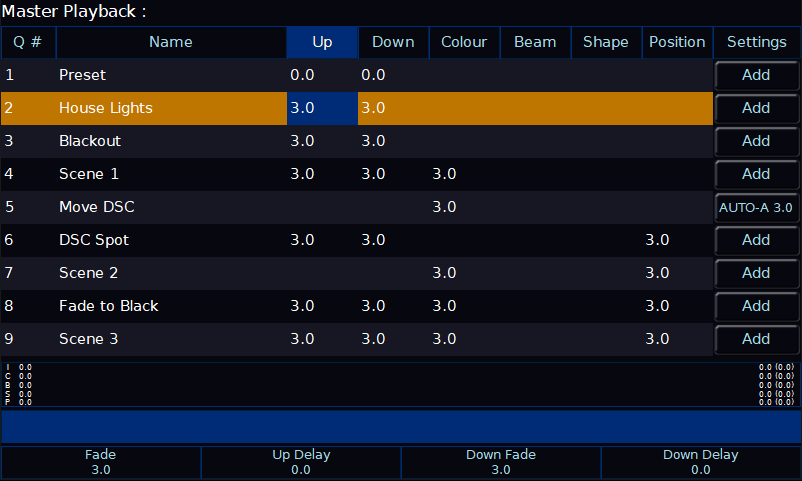

When an attribute has been recorded into a cue, timings are available, to configure how quickly your lights get to their recorded values when the cue is played back. Times for each attribute are displayed in columns in the Cues window, and each field can be edited, to customise your timings.

When you record a cue, it will be stored with the default fades for each attribute. Fade time defaults can be customised in Setup -> Defaults.
The default fade times are as follows:
- Fade Up and Fade Down - 3 seconds
- Colour and Position - 3 seconds
- Beam and Shape - 0 seconds

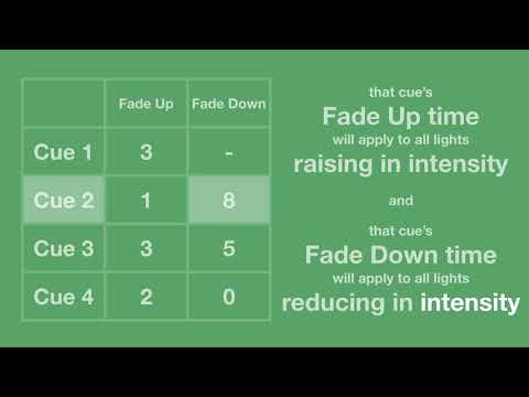

For fade up, it is the time it takes for any intensities to raise from their current level to get to their recorded levels.
For fade down, it is the time it takes for any intensities to lower from their current level to get to their recorded levels.

To edit your cue times, tap on the time you wish to edit in the Cues window. Your encoder wheels will then allow you to adjust the time for each attribute.
Tapping Fade Up or Fade Down will give the same intensity options on the encoders. The first encoder, will simply be Fade. This allows you to adjust the fade up and fade down together. Adjusting the fade down on the third encoder, then separates your up and down fades.
Each "tick" of the encoder wheel will increment by a second. If you wish to define half a second for example, tap on the middle encoder button of the time you wish to edit, and you will be able to customise a time, such as 1.5.

Delays will be shown in the Cues window in brackets, starting "(D: "
