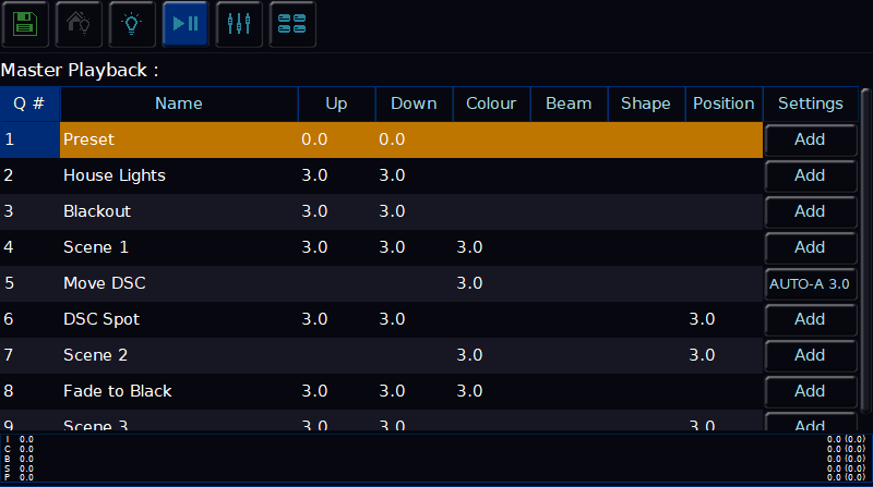

Cues Window
The Cues window displays all the cues within a single playback, with each cue being a different row. The columns show the name and various fade times and settings for each of those cues. The name of the playback is shown at the top of the window, with the cue fade progress bars for each attribute running along the bottom of the window.
