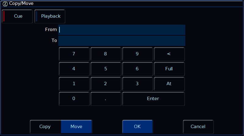

Individual cues, and whole playbacks, can be moved. Moving cues is useful to allow you to change the cue number, and therefore order, that your cues sit in the cue stack. Moving playbacks allows you to rearrange playbacks on your faders. For example, you may have multiple playbacks programmed, and when you need to use one, you could move it to the Master Playback.
To access the Move function, you can hold Shift and tap the Copy key.
Alternatively you can tap the Copy button, and then select Move from the Copy/Move window.

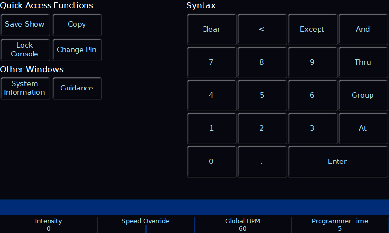

On FLX S consoles, the Copy button can be found by tapping the Z/Shift key.

To move a playback, hold Shift and press the Copy button. Then, tap the flashing button of the playback you wish to move, and then tap the flashing button you wish to move the playback to.
Alternatively, after pressing Copy to open the Copy/Move window, you can choose Move, and then choose Playback. This allows you to then type the number of the playback you wish to move in the “from” field, and the number you would like this playback to become in the “to” field.

To move a cue, hold Shift and tap the Copy button. Ensure Cue is selected in the window, which it should be by default. Then type the number of the cue you wish to move in the “from” field, and the number you wish to move it to in the “to” field. This will move cues from and to the currently viewed playback.
