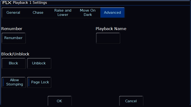

The last tab in the Playback Settings is Advanced.
Faders Playbacks
Playback Name
This allows a Playback to be named, which is displayed within the Faders window (pictured). FLX users can also use syntax to name a playback.

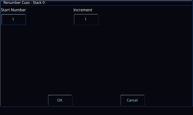

Renumbercues
Renumber

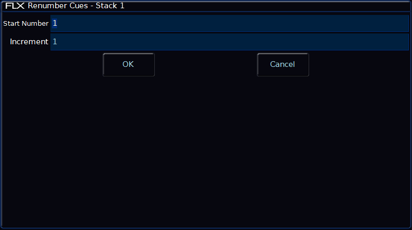

This option allows you to renumber all the programmed cues in the playback. To do this tap Renumber. This brings up the Renumber Cues box. You can then press OK, to renumber the cues sequentially from 1.
On FLX, you can type in the required Start Number and Increment in the fields provided and then select the OK button in the window.
Block
Pressing the Block button, will ask you whether you are sure you want to make the playback fully blocked. Pressing Yes allows all cues in the playback to be converted to block cues. This means the console automatically programs all the parameters at the values they would normally be output at when the cue is played back. You will no longer see purple values (tracked) in the Output window when the cues of this playback are played back.
Unblock
Pressing the Unblock button, will ask you whether you are sure you want to make the playback fully unblocked. Pressing Yes, will remove any parameters from cues where they are at the same value as in the previous cue, and they will instead track from the previous cue. You will no longer see white values (blocked) in the Output window when the cues of this playback are played back.
Allow Stomping
The Allow Stomping button allows for compatibility with show files saved in earlier software versions.
Page Lock
