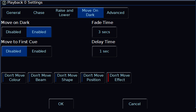

By default Move On Dark will be enabled. When this function is enabled for the playback, whenever a fixture goes dark (it’s intensity falls to zero, or the shutter is closed), ZerOS will look ahead in the playback to upcoming cues to see what values the colour, beam, shape and position parameters are next programmed at for that fixture. Although this is called Move On Dark, this isn't just for position parameters - this is for Colour, Beam and Shape too.
It will then output those values after the fixture has gone dark (according to the Move On Dark delay and fade times). When the fixture comes back on again in a later cue, the Colour, Beam, Shape and Position parameters will already be at their correct values and just the intensity will fade up or the shutter open.
The following Move On Dark settings are available for every playback...
Move to First Cue
This option is used when there are no more cues later in the playback for the fixture to Move on Dark to. If enabled, when fixtures go dark for the last time in the playback, they will move to the first cue they are used in. When disabled, once the fixtures go dark for the last time in the playback, they will not move.
Fade Time
This is the time it takes for the fixture's parameters to move to the values that they are in the next cue they're used. The default is 3 seconds, as this keeps larger older moving lights quieter when being prepared for when they're next used.
Delay Time
When a fixture goes dark, the delay time can be used to delay the fixtures, prior to them fading to their values using the fade time. The default is 1 seconds, meaning when a fixture goes dark, it waits a second, and then fades to the values required for the upcoming cue.

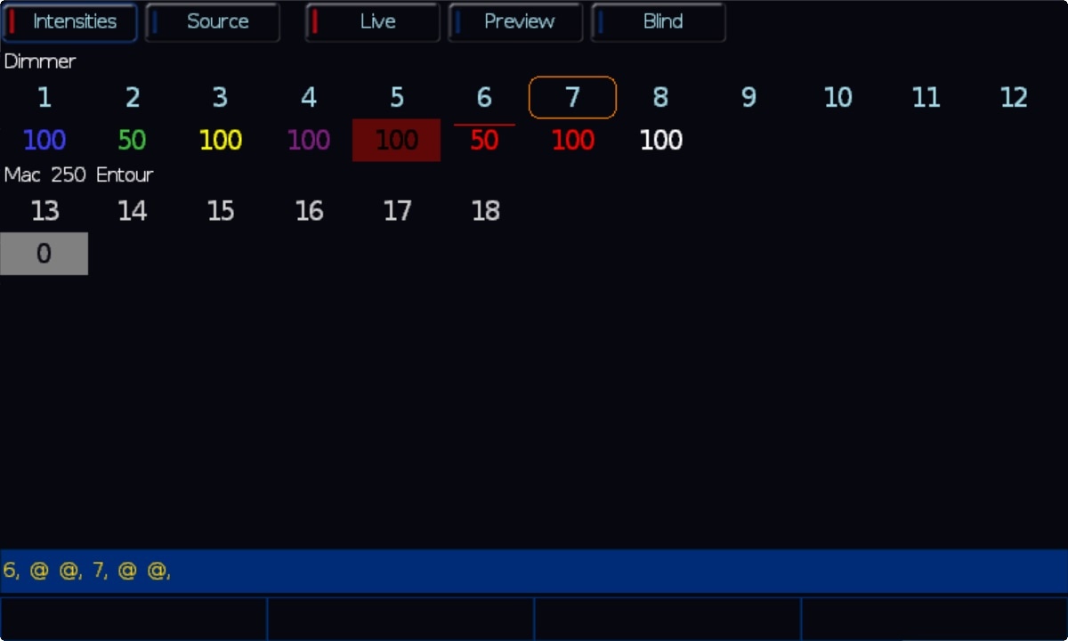

The Output Window will indicate which fixtures are being prepared by Move On Dark for when they're next used. Upon going into a cue which is able to move attributes for when they're next used, any fixtures that will be moved on dark will have a grey background around their intensity percentage.
This grey background will remain present throughout the fade down of the cue, the Move On Dark Delay, and the Move On Dark fade. The grey background will then disappear, indicating the fixtures are now ready for when they're next used.
Outputcolours
In this image, fixture 13 is currently being prepared by Move On Dark.

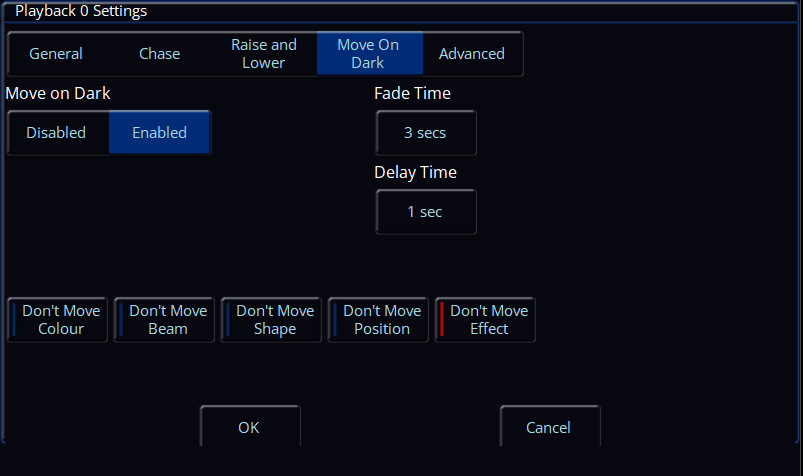

Don’t Move Attributes
This option allows you to disable a specific attribute from moving in dark across the whole playback. By default, only “Don’t Move Effect” will be enabled, indicated with a red stripe.
If an attribute is allowed to Move On Dark for a playback, attributes can be prevented from being Move On Dark in individual cues, using the Move/Don't Move options in the settings of each cue.
If an attribute is set to Don't Move for a playback, attributes can be forced to Move On Dark in individual cues, using the Move/Don't Move options in the settings of each cue.
