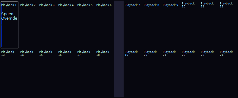

Speed Override can be chosen, to allow the fader to speed up or slow down cue crossfades occurring on the currently viewed playback. By default, Override will be at 50% to give “normal” crossfades, and so this fader will then need to be at half of its travel for no override. Raising the level above 50% will increase the crossfade speed proportionally and reducing the level below 50% will slow down the fade proportionally. Fully raised will snap the cue, and fully down will stop the cue.
Speed Override can also be used to speed up or slow down effects running in the currently viewed playback.

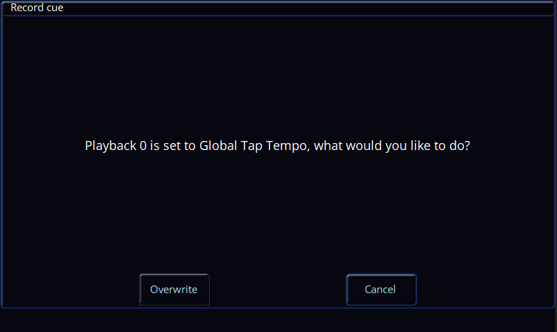

If you have configured an empty playback to become one of the four extra functions, the settings can be cleared by tapping Delete, followed by pressing the playback's button.
