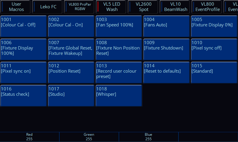

To create macros for your currently patched fixtures, go to the macros window, and press Automatically Create Macros.
Macros will be created in alphabetical order, to help you find the function you are after. The total number of fixture macros available on all FLX range consoles is 240. You will see fixture macros specific to the fixtures you have patched.
To apply a macro, select the fixture, and then tap the fixture macro you need.
You may find that some parameter details of your fixtures, are simply labelled "Macros". For example there are multiple details of the "Control" parameter in this image simply named "Macros".
This means that macros can be used to control that parameter, rather than using the parameter manually.
