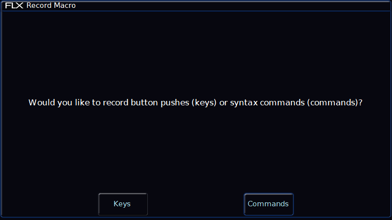

After doing this, you will receive the following message, allowing you to record either "Keys" or "Commands":
  • Keys will record any physical button presses you make on the console, Wings, or USB keyboards. It will capture key presses, repeats, and releases, meaning press-and-hold commands can be captured.
  • For example holding CLEAR and tapping Fader Funct. can be recorded into a macro to create a "Release All" button.
  • Commands will record just the text being typed into the command-line.
Therefore if you are simply recording a string of syntax, both Keys and Commands would record the same information, just in a different way.
Commands is the pre-selected option, meaning if you press Enter, this will be chosen.

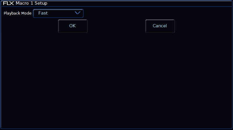

The playback speed of the macro commands/button presses can be configured in the macro settings. Macro settings can be accessed by holding Setup and tapping the onscreen macro tile, or using syntax:
Macro 2 3 Setup
Macrosetup
The Macro Settings allows you to use the Playback Mode drop down to toggle between Fast or Slow. Fast is the default, and will be suitable for almost all macros. Some macros that take you in and out of Setup for example, may require to be played back at a slower rate.

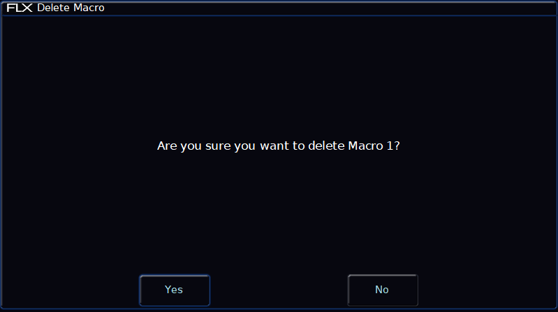

After choosing a macro to delete, the console will ask you to confirm this action before the command is executed. Once deleted, a macro cannot be recovered but can be recreated manually if required.
