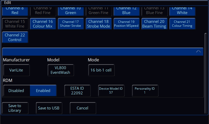

RDM
Exportfixturerdm
Upon exporting a fixture, you can also add RDM information to a fixture. The RDM information is in decimal (not hex), and includes the following information:
  • ESTA Manufacturer ID
  • Device Model ID
  • Personality ID
Upon detecting a connected RDM fixture, ZerOS will look at the fixtures in the ZerOS Library, plus any custom fixtures that have been loaded. If ZerOS sees a fixture in the library or a custom fixture, that has RDM information that matches the discovered fixture, ZerOS will then automatically patch it.
If ZerOS doesn't find a matching fixture, it will create a basic fixture personality based on the information it can obtain over RDM. This basic fixture personality can then be found in Add Fixtures. To find the RDM information of the discovered fixture, tap Setup -> Add Fixtures, find the RDM fixture that has been discovered, click Next > then Edit & Export. You can then view the RDM information, which could then be added to a custom fixture file if required.
