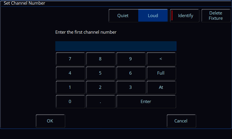

To change the channel number of a single fixture, tap on the channel number cell, and type a new fixture number. On FLX, this can be any number between 1-9999, on FLX S24 this is between 1-96, and on FLX S48 this is between 1-192. After changing the channel number of a fixture, that fixture can now be controlled using the new channel fader number.
To change the channel number of multiple fixtures at the same time, select the fixtures in the order you wish them to be numbered. Then select the column header button which is labelled Ch #. This will open an onscreen number pad. When you edit this value, the fixtures selected will be renumbered sequentially in the order they were selected and shown – they won’t all be given the same channel number.

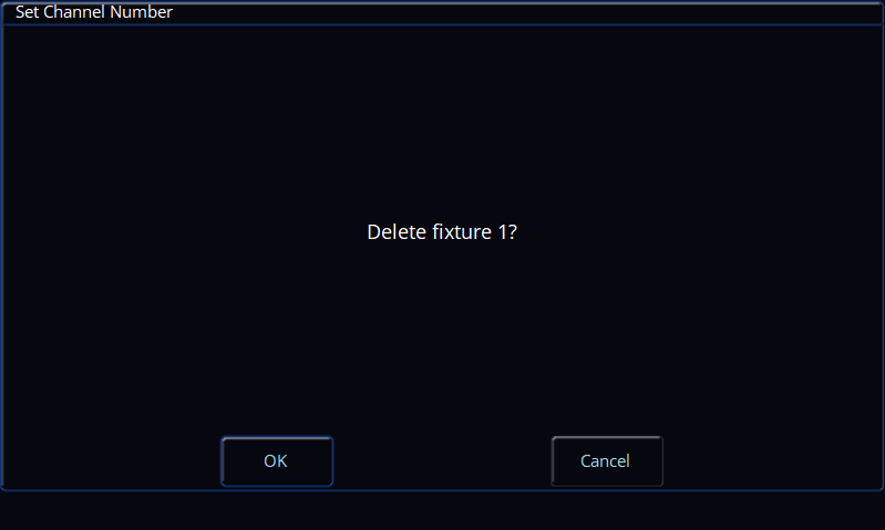

DELETE
Fixtures can be deleted from the Channel Number window, by pressing Delete Fixture.
Upon pressing Delete Fixture, you will be asked to confirm the operation. Deleting a fixture removes it from all cues, and is a permanent change to the show file. There is no undo function, so exercise caution when using this function.

If you click the Channel number button of an RDM fixture that's been discovered and patched by RigSync, there will be an "Identify" button shown. Tapping this, so that it has a red stripe, will send an RDM identify command to the fixture. The fixture will then flash its light output, or its menu screen.
Some fixtures have the ability to choose whether they are identified subtly or obviously. In these cases, a "Quiet" and "Loud" switch will be provided, to allow you to choose the identify mode.
