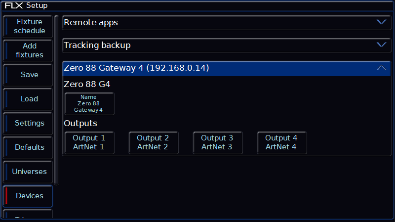

If you enable the Art-Net protocol in the Universes tab of Setup, any Art-Net devices ZerOS can see will be displayed in the Devices tab.
Setupdevicesartnet
In this image, Gateway 4 can be seen by ZerOS. This is how most Ethernet to DMX gateways (sometimes referred to as "nodes") will be displayed in Devices.

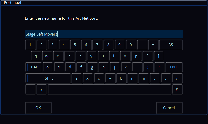

Artnetdeviceportlabel
Some Art-Net devices allow their individual DMX Output ports to be renamed. If they do, a "Port Label" field will be available to the left of the "Cancel" button.
For example, if port 2 of the gateway is outputting universe 2, and your Stage Left Movers are on universe 2 connected to that port, you could rename the port, so you know exactly which fixtures are connected to this physical DMX output.
