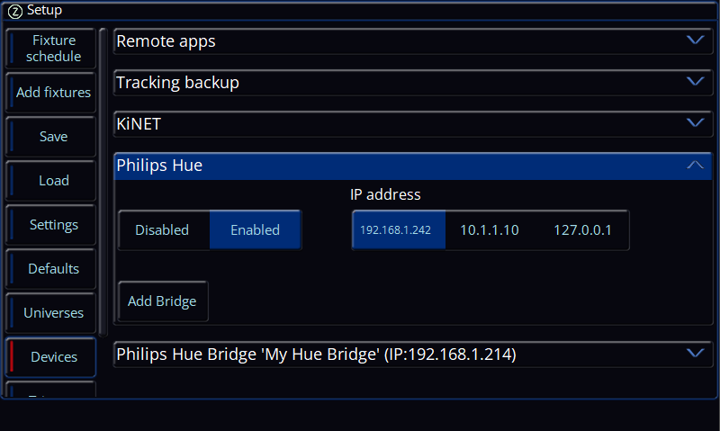

Philips Hue can be enabled from the Devices tab of Setup, in the Philips Hue panel. Once enabled, the Philips Hue network settings can then be configured.

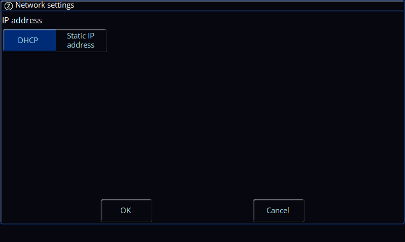

Hue Bridges will default to DHCP. Therefore, if you have a DHCP server on your console's network, you will be able to connect the Hue Bridge, and simply choose DHCP on your console. The DHCP server will then ensure your console and your Hue Bridge can talk to one another. If you do not have a DHCP server on your console's network, the Hue Bridge's network settings will need to be manually configured, to a static IP address in range of your console.

Once the network settings have been configured, Hue Bridges on your console's network should automatically appear after a few seconds, and will be displayed as separate panels in the Device tab. Once a Hue Bridge has been found, it will be displayed with its name and IP address shown.

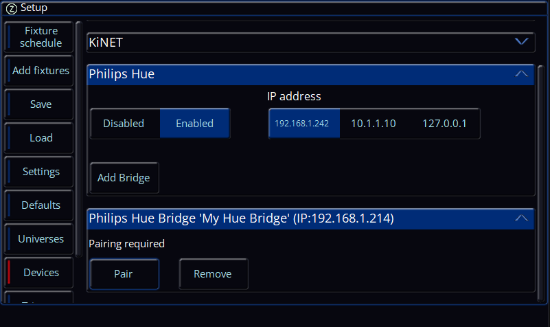

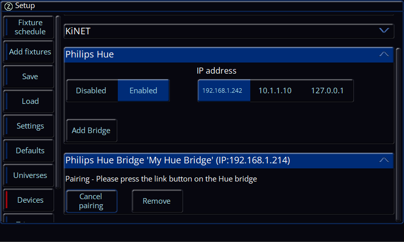

You will then need to pair your console with your Hue Bridge. To do this, click the "Pair" button in the Hue Bridge's panel within the Devices tab. The console will then be ready to pair. You can then press the large link button on top of the Hue Bridge.

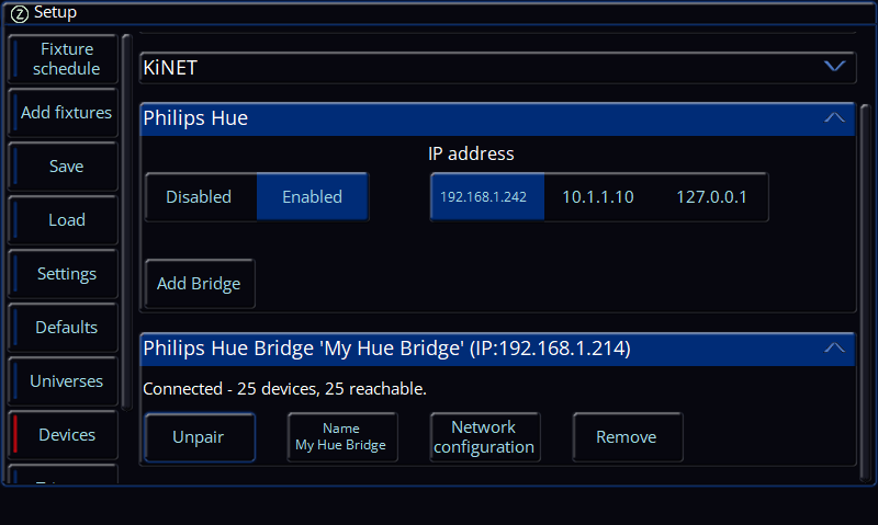

Once paired, ZerOS will detect all of the Smart Light Bulbs and Smart Plugs that may be connected to the Hue Bridge, and add them into the console. This functionality is very similar to RigSync detecting and patching RDM fixtures.
Once ZerOS has been paired with a Hue Bridge, it will have control. No other Philips Hue controls, such as Smart Switches or the Philips Hue app, will be able to take control, until ZerOS has been unpaired.
After all the Smart Light Bulbs and Smart Plugs have been added in, you can then exit Setup on your console by tapping the Setup key. You will then be able to control and program the connected Smart Light Bulbs and Smart Plugs. The Smart Light Bulbs and Smart Plugs will be named using their preconfigured Hue names.

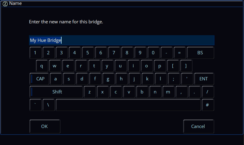

Hue Bridges can be renamed from ZerOS. To rename a Hue Bridge, click the Name button within a Hue Bridge's panel in the Devices tab.
It is possible to remotely change a detected Hue Bridge's network settings from ZerOS. To do this, click the "Network Configuration" button within the Hue Bridge's panel in the Devices tab. You can then choose whether the bridge is set to DHCP, or a Static IP address.

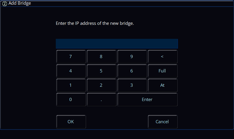

If you need to manually connect to a Hue Bridge, click the Add Bridge button in the Philips Hue panel, and type in the IP address of your bridge.

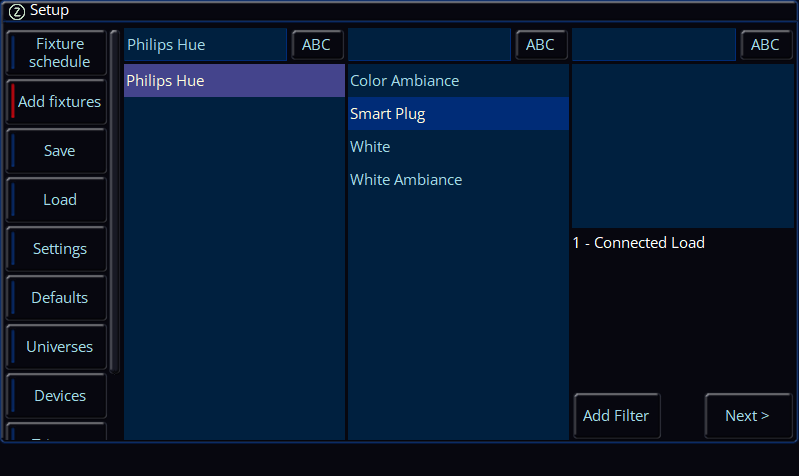

Philips Hue Smart Light Bulbs and Smart Plugs will be automatically added, but are also available in Add Fixtures.
