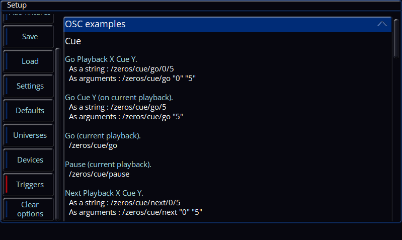

OSC Examples
The OSC Examples section of the Triggers tab, lists all of the OSC commands that ZerOS can receive.

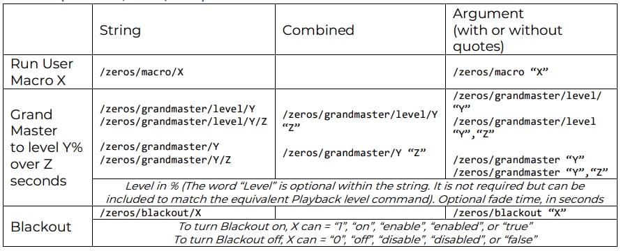

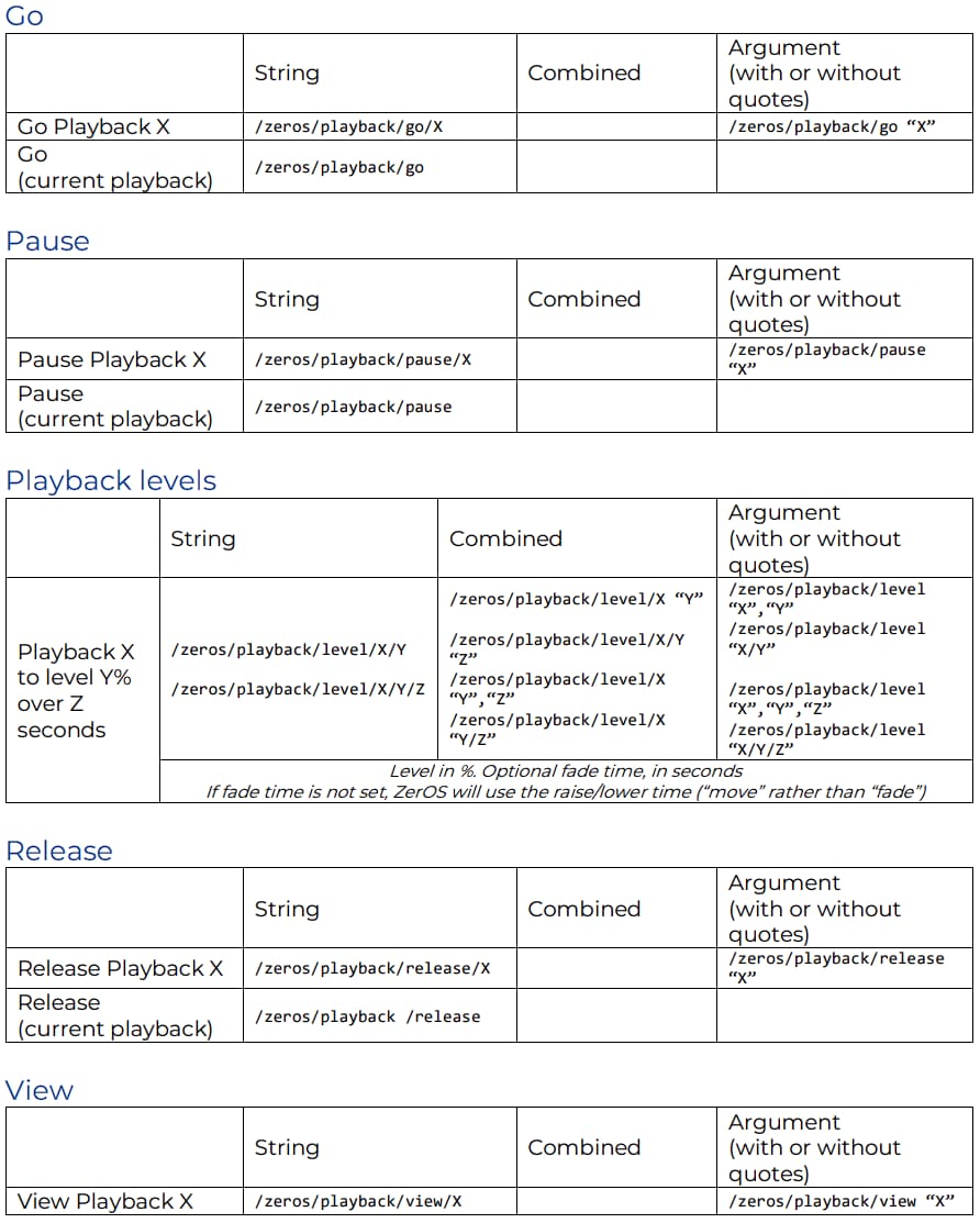

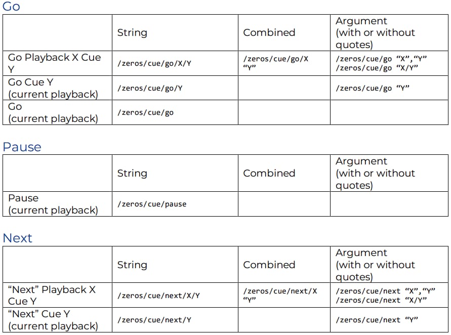

Commands can be received as a string, as an argument (with or without quotes) or combined. For example, the following commands would all trigger Cue 5 of Playback 1:
- /zeros/cue/go/1/5
- /zeros/cue/go/1 “5”
- /zeros/cue/go “1”,“5”
- /zeros/cue/go “1/5”

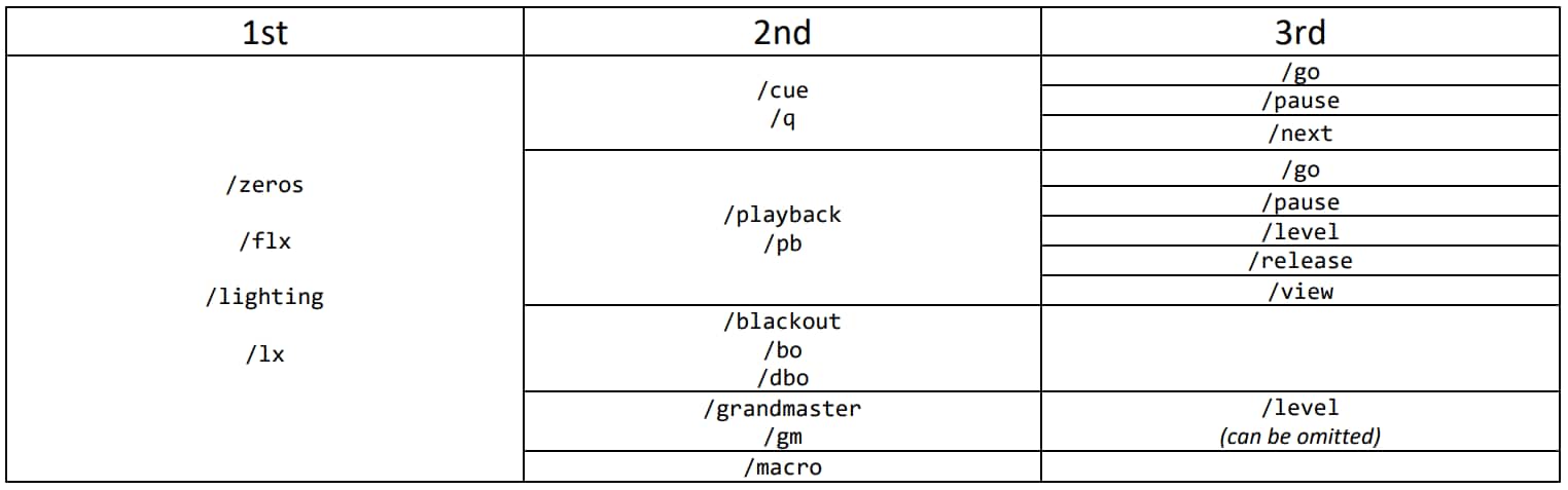

The below table lists all available commands. Where alternative "shorthand" commands are listed in the same cell, these are interchangeable - made available to speed up programming. For example "/zeros/cue/go" and "/lx/q/go" have identical functionality - the first being easier to read, and second being quicker to type.
