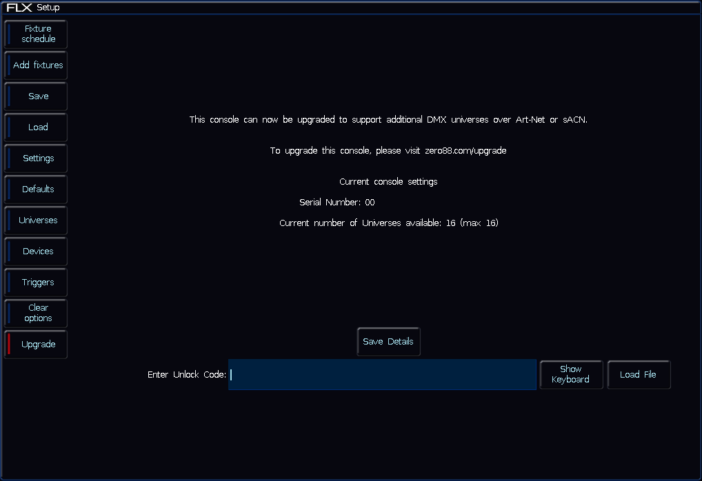

To upgrade, tap Setup, and choose "Upgrade", which will be the bottom tab from the left-hand options.
Then click Save Details to save a text file to USB which includes all the information required for the upgrade.
Once your universe upgrade has been approved, you will be emailed your console's universe upgrade code file. This can then be saved to a USB drive, and loaded into the console from Setup -> Upgrade -> Load File
After loading the unlock code, the console will then ask to be restarted. The next time the console boots, the extra universes will be unlocked.
