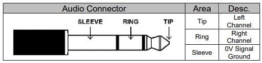

Sound to Light
A stereo ¼” jack socket provides basic Sound to Light functionality. Left and right channels are mixed internally.

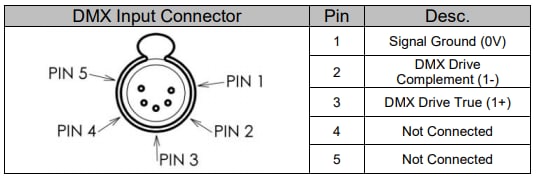

DMX output
Two female Neutrik 5 pin XLR, isolated, with voltage protection and data output indicator. Data on channels 1 – 512 only. RDM support included.
