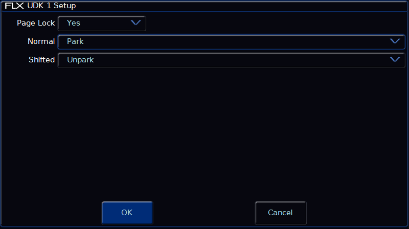

To access the Park/Unpark functions, hold Setup and tap an empty UDK. It is common to configure the Normal UDK function to be Park, and the Shifted UDK function to be Unpark. After choosing Park and Unpark, click OK.
In the Faders window, the normal Park function will be shown, on the onscreen UDK, with the shifted Unpark function shown in (brackets).
