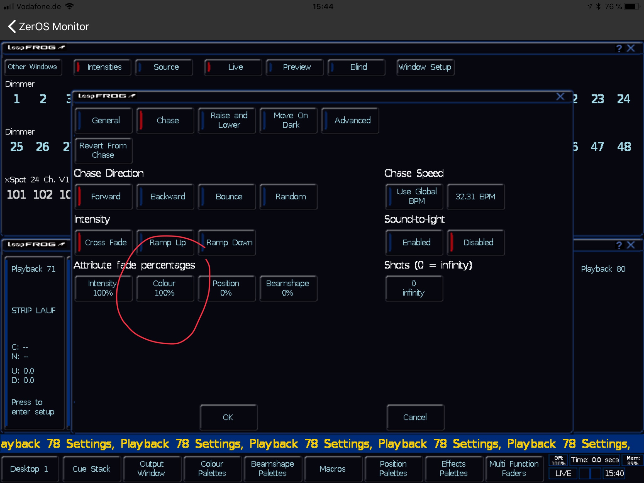

  5. Hi Scloue, is it a led-chaser wich won‘t fade just snap? i tried it on my leapfrog and had the same effect. in your playback-parameters you can choose the chaser you will edit. Here you find an parameter-window where you can change the parameters of the playbacks. In this window you can change the „attribute fade percentages“. Change the ‚colour‘ attribute to 100% an you will get your chaser fade instead of snap. The factory default setting is intensity 100% and colour 0% but your leds will need the colour attribute changed to 100%. Mathias
