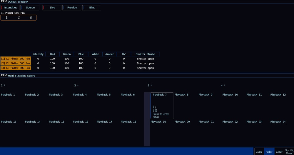

  11. Ok I got it. Thanks for bringing long forgotten things to my mind. Corona thank you 😍 You can bring up the cue stack of a fader by pressing <view> and the button under the fader. Thanks Kevin
  12. Kevin, you mean this? I placed it randomly on playback 7. There is only one cue at this fader.
