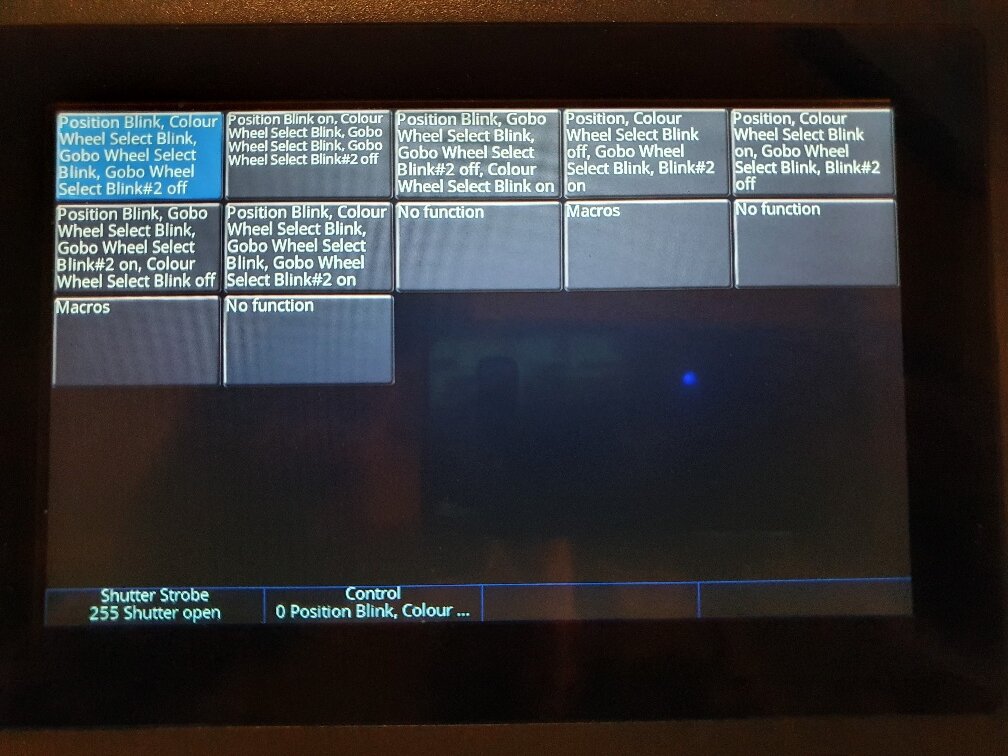

  3. Hi Not sure whether this should be an FLX or a Fixture post... We were previously using a non-library personality for the above fixture which had a "lamp off" option on the Control encoder wheel (from memory this was around position/DMX 235 on the wheel). Obviously, this is quite important for extending the lamp life on these fixtures. However, when we upgraded the desk to zeros 7.13 recently, we converted these fixtures to the Zero88 library version which seems fine other than we have lost the above "lamp off" option. Various other reset options also seem to be missing which ae present in the lamp spec. I've looked over all the encoder wheels just in case it has moved but can't find the "lamp off" option anywhere. I've attached the show file and photo of the control encoder wheel (2nd press on "Beam" button.) We're using the 19 channel version of the personality. Grateful for any help you can offer. Thanks Mike KERRY GODLIMAN 101122.zos
  4. Many thanks Edward. We're now fully updated to Zeros 7.13 with fixtures upgraded to the latest library versions and enjoying the additional features this has unlocked on the Intimidators. Kind regards Mike
