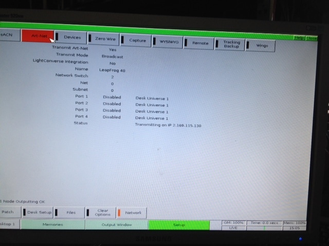

ARTNet stopped working with Leap Frog 48 zero OS 7.0.8?

Oh my. This isn't my day. I have solved it. I had to set port 1 from disabled to 1...I'm sorry for the post, this can be locked. -
Hi, We've had a little battle to set up our leapfrog with an artnet node. After a while it worked. Now, I updated my frog to the latest software version and artnet doesn't work anymore? The DATA LED is flashing with the ethernet connected. Here's a screenshot of the settings on the desk. I don't know if something is wrong here. ARTNet universe is from : oxo net[box 8] screenshot:
