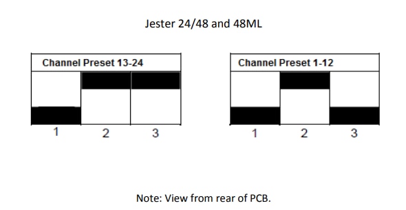

just for info; If your console starts with only 24 channels, and the other 24 always remain lit then:
Open the console and check the dipswitches
-preset 1-12 must be: 2 ON, 1&3 OFF
-preset 13-24 must be: 2&3 ON, 1 OFF
Otherwise Check the ribbon cable connections
For my part a dipswitch (13-24) was not in the right position.
