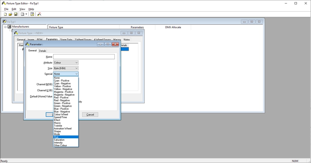

scottydog75 Posted April 24, 2025 Report Posted April 24, 2025 I've not touched a Jester for a long time, however I've fired up the old Zero88 Fixture Editor tool, and it is possible to assign Hue, Saturation, and Intensity, against the colour parameter, so this could be possible if you've got some time to test it! Quote

invisible Posted April 24, 2025 Author Report Posted April 24, 2025 I think that's only a label for fixtures that use HSI internally, but does not actually add any "math" behind the scenes (as e.g. the virtual dimmer channel does). There would need to be a way to enter 3 DMX adresses for each value (i.e. the R/G/B channels that should be calculated from HSI). But I'll give it a try. Quote
