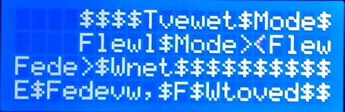

When I booted up our Jester 12/24, the LCD panel showed gobbledegook (jpg attached).
I tried resetting the desk, clearing memories etc from Superuser (using the attached VGA monitor, which displayed everything as expected) but this made no difference.
The desk otherwise appears to work so we carried on using it.
The gobbledegook on the LCD panel changed during the day but didn't go away.
I downloaded the memories and loaded to PhantomJester and they seem fine.
The unit is about 18 months old and receives relatively light use from our am-dram group - around 35 rehearsals and performances to date.
The store room felt pretty cold and damp (condensation) so we left the Jester at room temperature for a while before using it.
Anyone else come across this problem?
