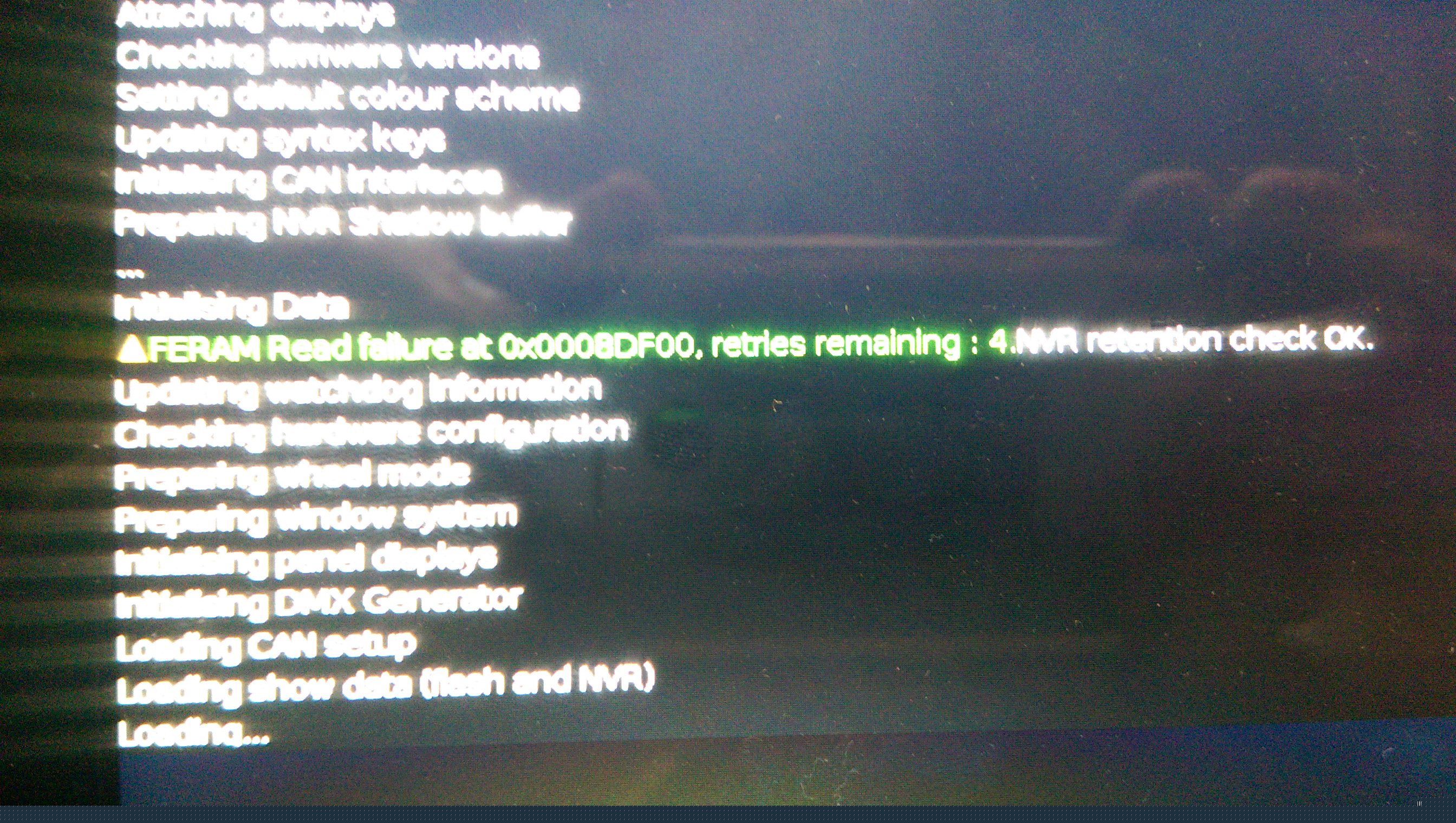

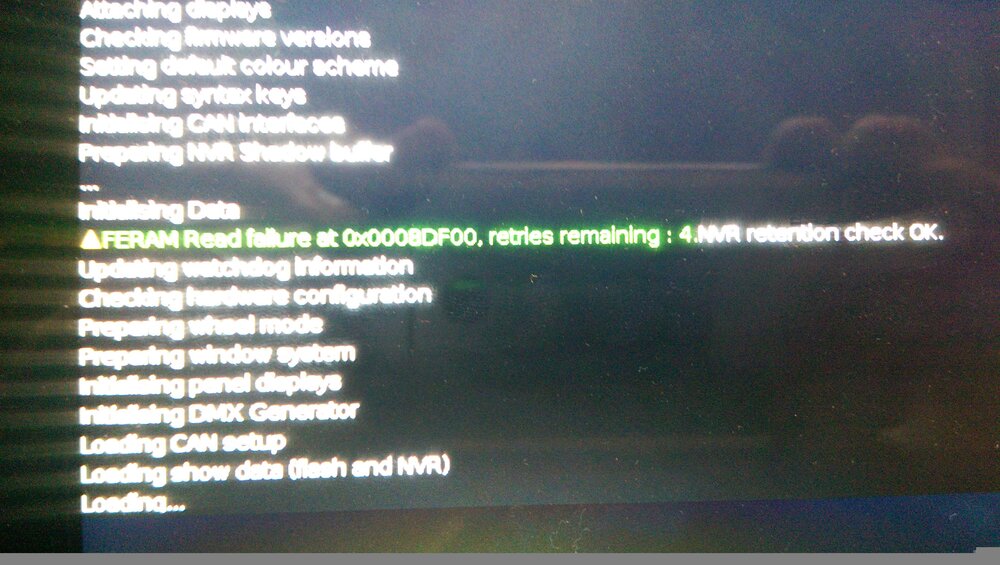

  20. hi Everyone in the Systemtext is something writen what looks for me like a warning (??) does somebody knowes what this means? FERAM Read failure at 0x0008DF00, retries remaining: 4NVR retention check OK I found this allready several Times but didn't get attention to it, cause the Desk work proberly. But now i am short time befor a premiere and i am not shure if this massage should makes me nervous. denks a lot for answers...Luk
