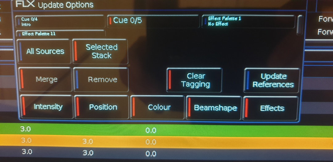

Everything posted by Techie_v2

  2. So now I have the full show programmed, if I go to the cue when the effect stops, select the movers, hold update, turn smart tag off, this should sort it? (desk is in tracking mode now) Thanks

  4. Yeah im trying to program ours now! Here is the windows I get when I hold update.... Thanks
