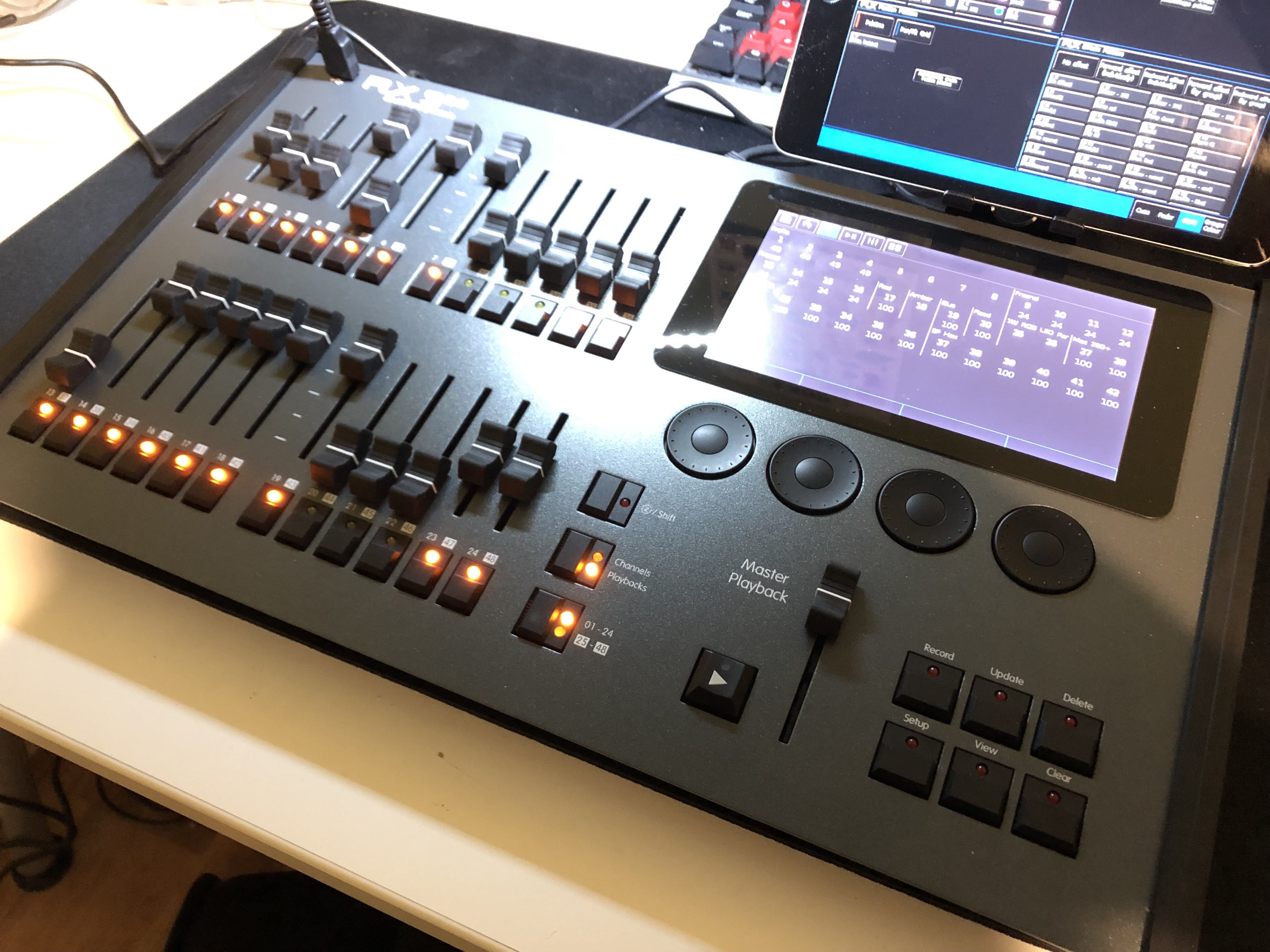

  8. Pic very much appreciated along with the list of items. Many thanks!
