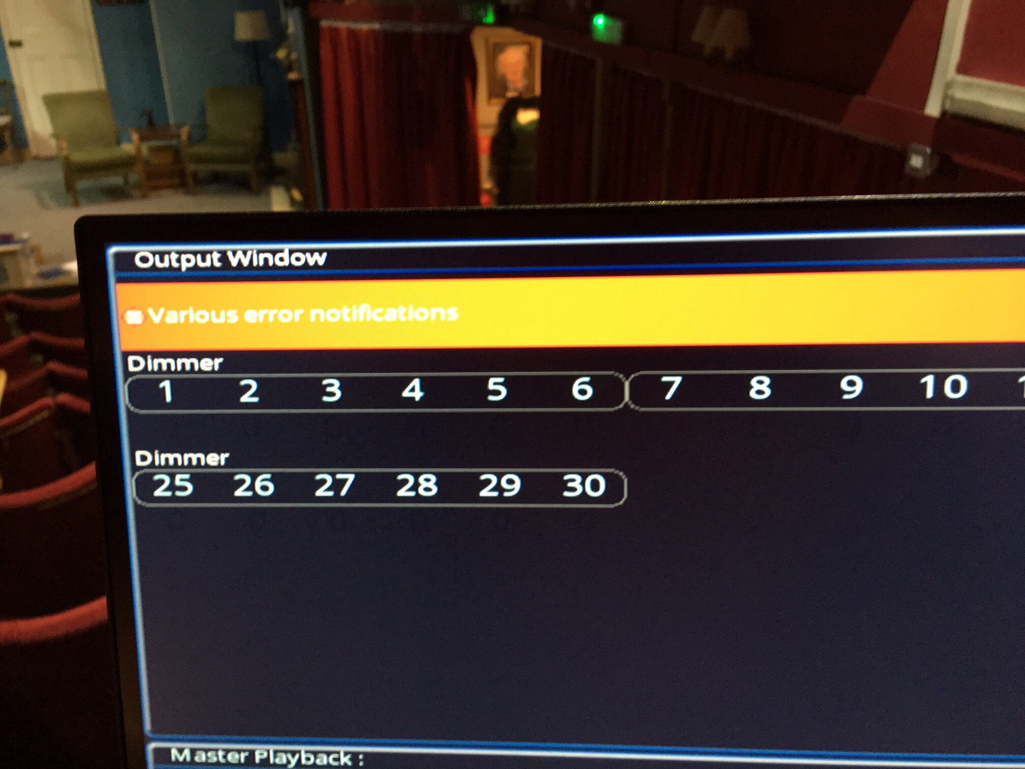

Hi I am running an FLX S48 with 5 packs of Beta Pack 3 giving 30 dimmer channels. In the last couple of days whilst plotting a new show the desk has started flashing up an error notification warning on the the touch screen and external monitor on power up. See the attched photos. There are 7 error message entries all with an identical timestamp and identifying 7 unpatched RDM devices that are not responding. It is not clear what these 7 devices refers to. The 5 Betapacks are working just fine and responding to the desk. Whilst you can delete these messages and the desk/dimmers continue to work the same message will appear next time the system is powered up. The Betapacks are run with RDM disabled and have simply been connected by creating 30 channels worth of Dimmer fixtures on the desk. There is no evidence of any other fixtures on the desk. It doens't make any difference which order the desk and racks are powered up. What is causing this and how do we get rid of these error messages? I cant find anything in the manual to offer advice on this issue.
