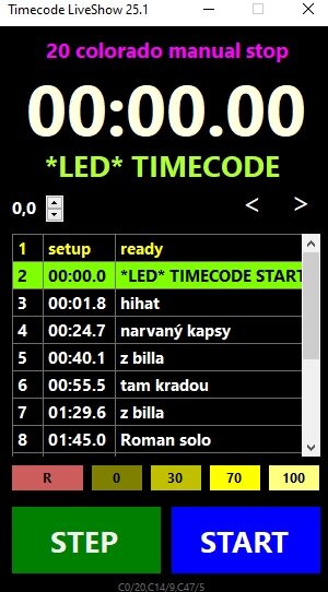

Tomas Pokorny Posted February 17, 2025 Report Posted February 17, 2025 I have my own solution for playlists with manually started timecode for zero 88 if you need it. The playlist looks like this. #20 colorado manual stop setup|C0/20,C14/9,C47/5|ready 00:00.0|P2|*LED* TIMECODE START 00:01.8|L1/100/4|hihat 00:24.7|R45,P3,C47/5,P36|narvaný kapsy 00:40.1|C33/2,P2,R47,R36|z billa 00:55.5|R33,R2,C47/5,P36|tam kradou 01:29.6|C33/2,P2,R47,R36|z billa 01:45.0|R33,R2,C47/5|Roman solo 02:00.8|C33/2,P2,R47|z billa 02:14.8|R33,R2|o ty 02:15.5|C33/2,L16/100/1|o ty Explanations: C0/20 = cue 20 in playback 0 L1/100/4 = level Playback 1 to 100 via 4 sec. P3 = playback 3 max R33 = release playback 33 Automatically converts to OSC commands for FLX. 1 Quote
