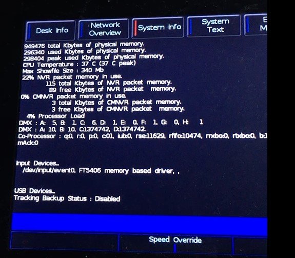

OK, so the saga continues.... No LED desk lamps plugged in tonight, but still some DMX issues on the lamps. I updated a couple of cues as part of a slight tweak and as I was saving to USB I saw an odd message flash up. Delving back into the system dialogue and I spotted the errors coming up on the screen, as shown in the files below... These were streaming through in batches of a few at a time. I have a video, but too big to upload... (I can drop you a Dropbox link if it helps, but doesn't really show any more than the image, just the frequency and timing of error messages...) This was after a clean reboot and just saving to USB stick.
