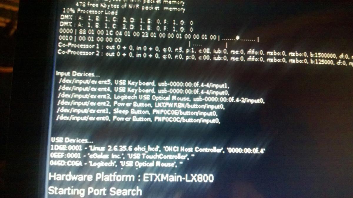

  13. Hi Fensch I'm in exactly the same situation with my Benq Touch screen - it only appears as a USB device. The info you've supplied will (hopefully) give Jon and the software team what they need to check/add the associated driver to include into a software release - maybe a beta? Jon: Any ideas on timescales to add the drivers for this and my (ZOS-5441) touchscreens? Regards Mike

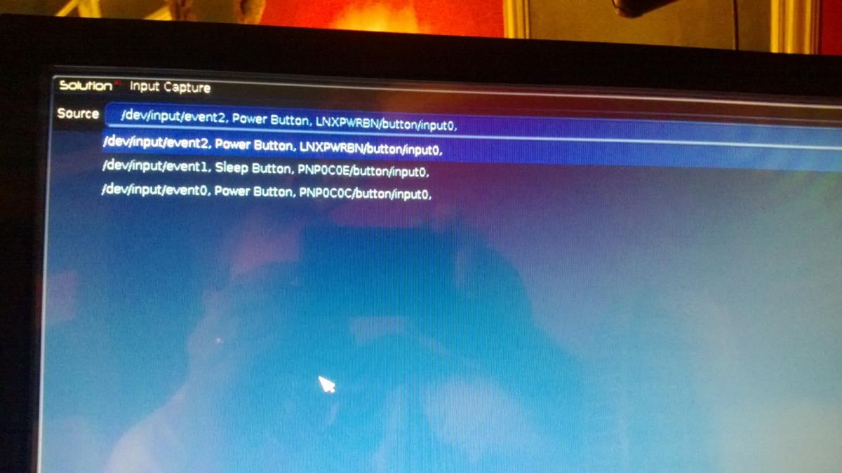

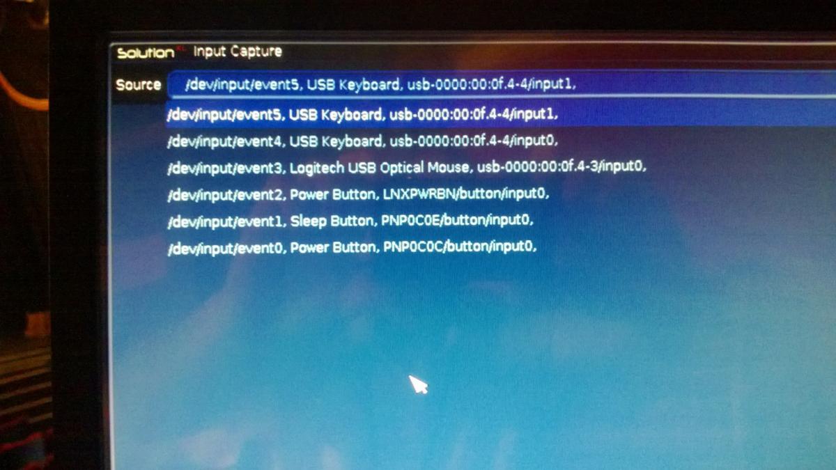

  16. Fensch, To help things along; If you open the System Information window (listed under 'Other Windows' in the Output Window) the touch screen should be listed as a USB device. If you can copy the UID/PID and any other info seen from there, it may help track down what driver/kernel version is needed to support the Touch Screen. Could you also go to SETUP> Desk Setup > Peripherals. There's a button called "Input Capture". If you go into this screen, select the touchscreen from the drop down list, and then move your finger around the screen, and capture all the data that the monitor is sending through the USB port. This will help determine why your monitor isn't working. Ideally, move your finger right to the edges, and into the corners, to capture as much information as possible. Regards Mike

  23. Jon, The font was a tad small but I believe the desk is seeing the touchscreen as there was any entry; 0EEF:0001 - 'eGalax Inc','USB TouchController','' Picture attached. Regards Mike
