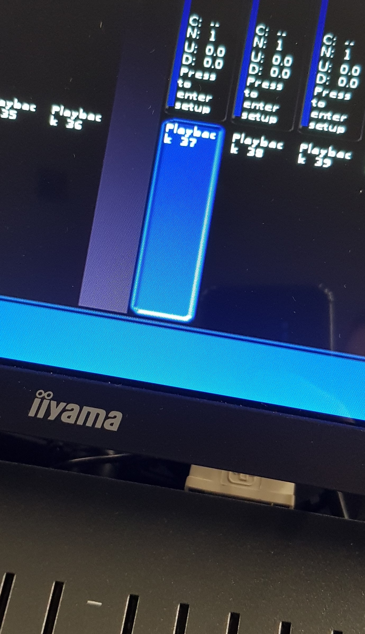

lugamil Posted November 8, 2020 Author Report Posted November 8, 2020 Thank you for the quick response Quote Colour will mix LTP between playbacks and manual values. This stands for Latest Takes Precedence, and as your White Strobe playback is the latest colour instruction for that light, it is then white until it is sent a new instruction. I assume that means what I want to do is not possible? Quote Sorry to hear this - does this playback have its fader function configured to “Manual Fade”, rather than HTP Master? No idea, I haven't really tested or looked into it yet, just saw it happen a few times but it never really hindered what I was doing so I didn't really look into it. I did take a picture once to show you what I mean. To be clear, we're talking about playback 37. I recorded something on this playback and I noticed that even when the fader was at 0 it was still backlit as if it was active. I deleted the playback but it was still backlit and this is when I took this picture. I don't remember if it was backlit instantly after I recorded the playback or only after I changed the value of the fader. I also don't remember if this was the first playback I recorded after starting the desk. Sorry I can't tell you more, I will try to recreate it the next time and let you know how I did it if I can.
lugamil Posted November 8, 2020 Author Report Posted November 8, 2020 Hello, Quote This looks like it is being pressed by the external monitor. If you tap it, does it “release”? No it stays like that even after cycling through the different views, recording a new playback onto the fader, deleting a playback on that fader, ... As I said, the only way I've found to fix it thus far is restarting / power cycling the console. I haven't been able to consistently recreate it. I will let you know if I figure it out. Mil
Edward Z88 Posted November 8, 2020 Report Posted November 8, 2020 Hello, 5 hours ago, lugamil said: I assume that means what I want to do is not possible? After releasing your white strobe, the console won’t simply resume the previous manual values, as white has become the latest colour instruction for the light. You could do this by mixing between playbacks, rather than playbacks and manual values. For example, you could have playback 1 as intensity, playback 2 as white strobe, and then playback 3 could contain several cues of different colours. This would allow you to choose a colour using the cues in playback 3 (fader nor required), and then raise the intensity with playback fader 1. You could then strobe the fixtures in white using playback 2, and when you release playback 2, the current colour in playback 3 would resume. 5 hours ago, lugamil said: I did take a picture once to show you what I mean. Thanks for attaching the picture. It looks like the fader is in its pressed state - if you tap it does it “release”. 5 hours ago, lugamil said: Sorry I can't tell you more, I will try to recreate it the next time and let you know how I did it if I can. No problem - let me know how you get on. If you have any questions let me know. Edward Edward Smith Formerly: Zero 88 Product Specialist - Email Support Currently: Obsidian Control Systems Product Specialist
Edward Z88 Posted November 8, 2020 Report Posted November 8, 2020 4 minutes ago, lugamil said: As I said, the only way I've found to fix it thus far is restarting / power cycling the console. I haven't been able to consistently recreate it. I will let you know if I figure it out. OK thanks for confirming. To check that it isn’t being continuously pressed, you can tap Z/Shift -> System Information -> Event Monitor. This will display information when buttons are pressed, faders are moved, or the monitors are touched. If you have any questions let me know. Edward Edward Smith Formerly: Zero 88 Product Specialist - Email Support Currently: Obsidian Control Systems Product Specialist
