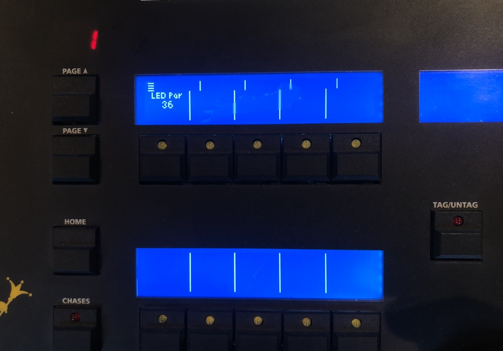

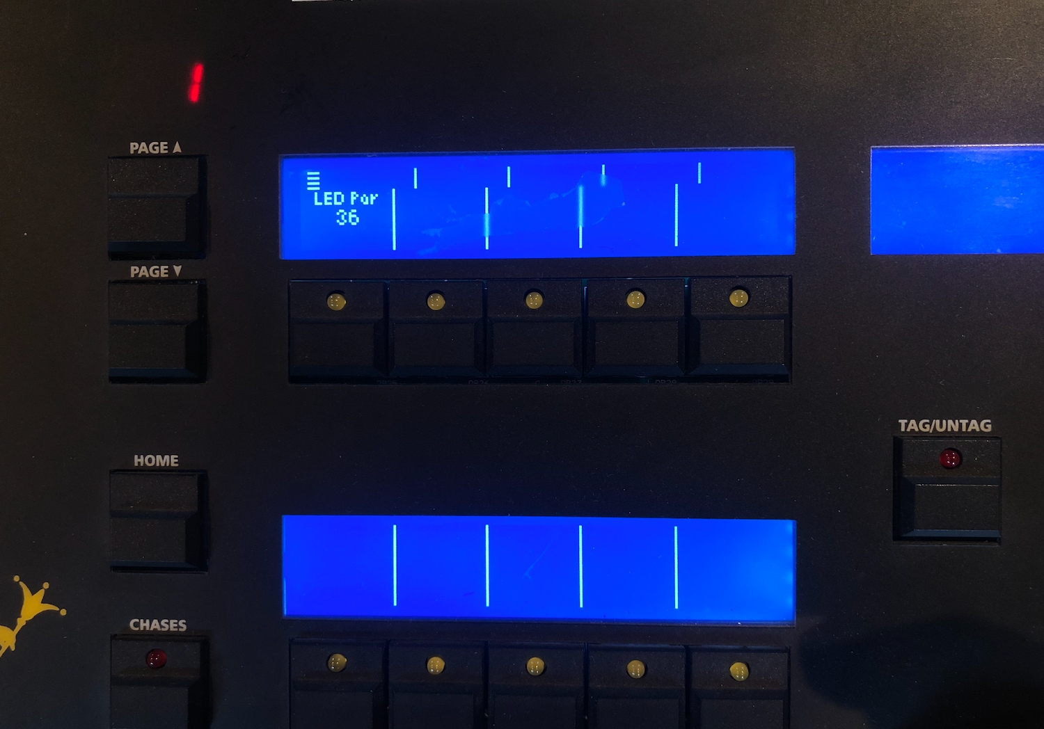

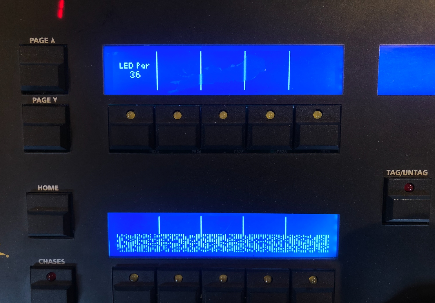

Just guessing but there is probably a ribbon cable dedicated to the displays (separate to wheels, buttons etc). I’m sure that was the case when I opened my Fat Frog a few weeks back. If you’re up for opening it I’d check that as a common cause - ie highly unlikely all LCDs themselves went bad at the same time! - Today

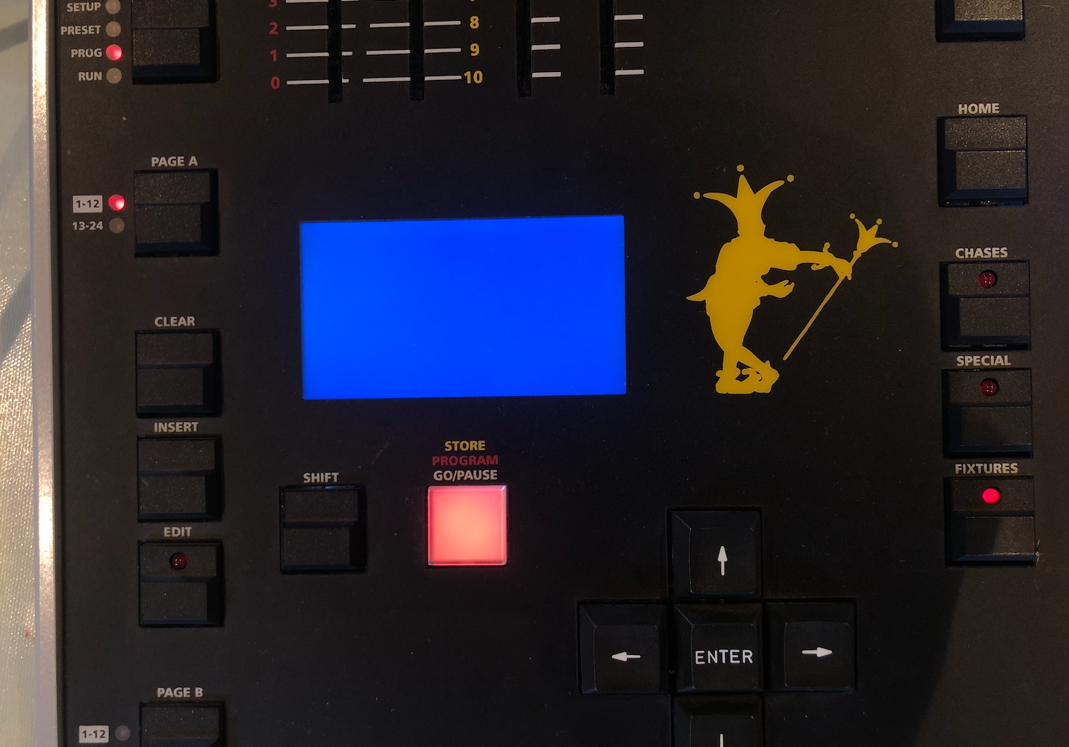

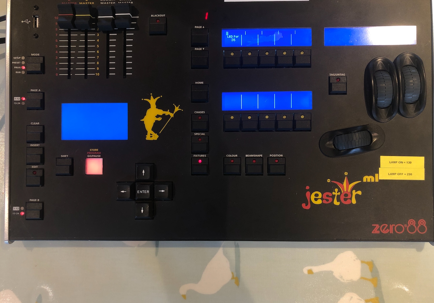

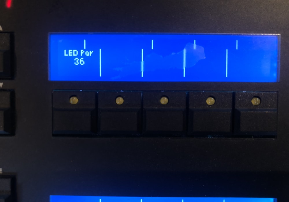

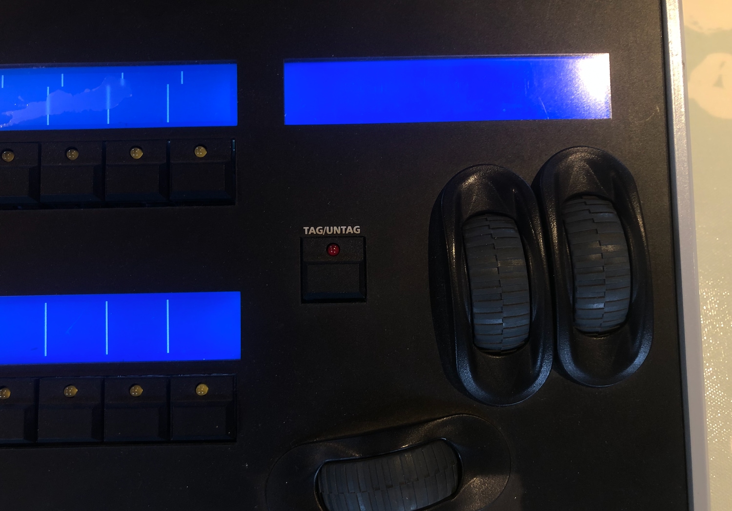

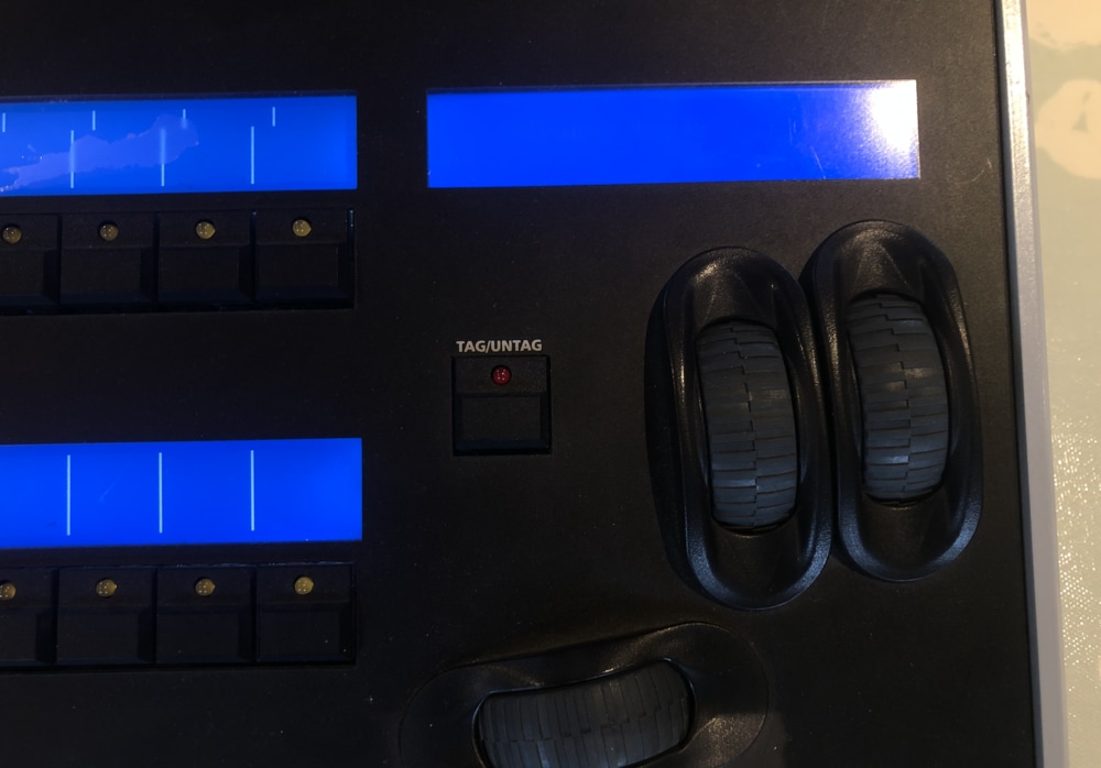

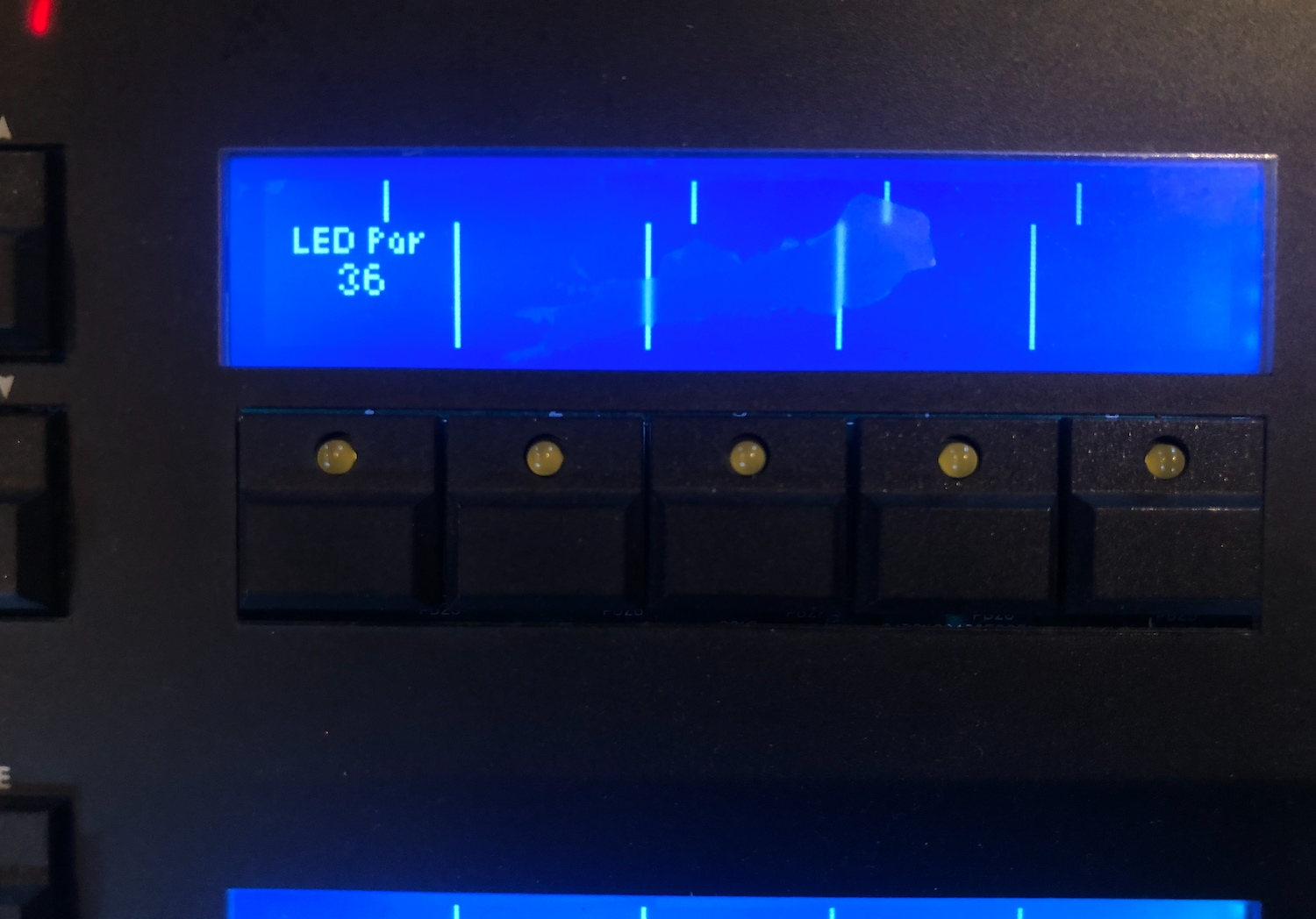

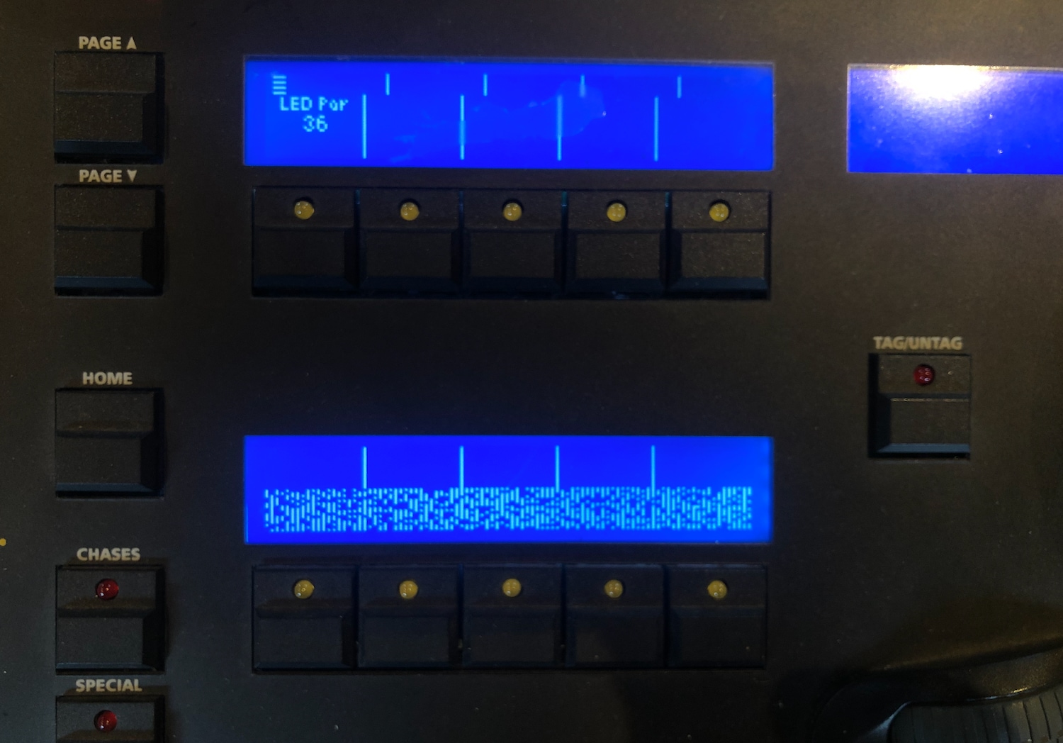

Just an update - I've turned on the desk again to see if the issue had gone (due to intermittence) and I am now presented with this on the bottom LCD: However, when tapping C, B or P buttons, the top LCD goes back to normal instead of the offset lines as shown below: -
Archie D started following JesterML LCDs blank [still backlit] and MFK lcd top row malformed
Hi all, I have an issue with my JesterML that seems intermittent. It appears to only have started having this issue since a few days ago. The issue is when I turn on and boot up the desk, the main LCD is blank (but still backlit), same with the wheel LCD. The top MFK lcd is showing content, but slightly malformed on the top row (see pics below). Bottom MFK lcd seems fine so far. This issue sometimes happens when I turn the desk on, and sometimes doesn't happen. DMX output still works fine, same with monitor VGA output from the back ports. Buttons all still work, so do the wheels, as the red LEDs in the buttons do change when I press them to the desired option I want to select. It's the LCDs that are the issue. Another thing to add is that on the top MFK lcd, when I select either Colour, Beamshape or Position, the four horizontal bars you see disappear and it just goes to how picture E shows. Picture A: Whole desk view Picture B: The MFK LCDs Picture C : Main LCD Picture D : Wheel LCD Picture E: four horizontal bars have now disappeared after selecting C, B or P Pictures are attached below. If anyone knows the problem here, I would be incredibly grateful if you could help me. Thank you. Perhaps it is a loose connection inside, but maybe something damaged? I'm not sure. I wanted to be careful and not open the desk just yet in case something goes wrong. Picture A Picture B Picture C Picture D Picture E
