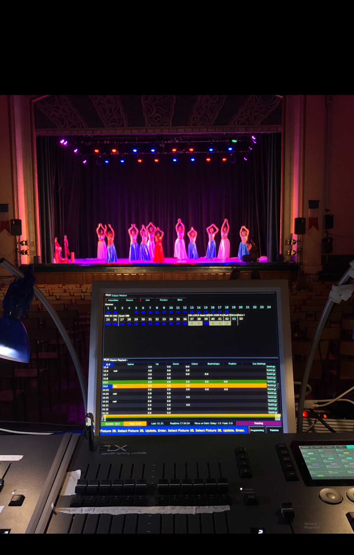

Hello Kevin, Today I have been to the theater where I have my equipment installed for a Saturday show. I spent the afternoon on the console with all the material and so it is more speaking. I have some difficulty for some things because I do not have all the possible manipulations in mind. And especially as you say I'm still with the logic of old consoles ... But over the hours things are better and I can do things. For the moment what I do not find more practical is some parameters of not being able to have on hand, except to make a playback. (actually a sub group) Then the different layers of fade are also to be integrated. It's confusing at the beginning, but in fact logical when one wants to refine things ... One of the other things that are missing is to be able to 24/48 on the same channel to put several DMX addresses. As for example for dimmers, or we can put several circuits on a same fader. I solved the problem with a playback. My concern at the level of playblack (in any case this afternoon) I wanted to make a UV playback (since the UV I only with the rotary knob) and in fact I did not succeed to have them. The LEDs first go on white and then after three seconds go to UV ... Then the other difficulties is when on an effect you position a Lyre on a CUE (example 4) and that it lasts on several cue 5, cue 6, you have to copy the effect then build the entourage to find the position . But since I like that the lyre is positioned before it turns on, it is necessary to find the position for the CUE 3 and ditto I like at the end when the lyre goes black (CUE 7) that the position does not move ... (except when I look for effects) But I see in the afternoon the power of the machine ... Then I understand why the wings are more positive. There I have one more wings and I think in the times to come (if the money is there) I will go on a wings and more to have more access on hand. canals or playblack .... In any case a big thank you for your help, eric
Ah OK You re in the same configuration then me. 24 to 48 Conventionnal 36 to 48 LED 5 Lyre Wash 4 lyre Beam Only for dance (Artistic)
