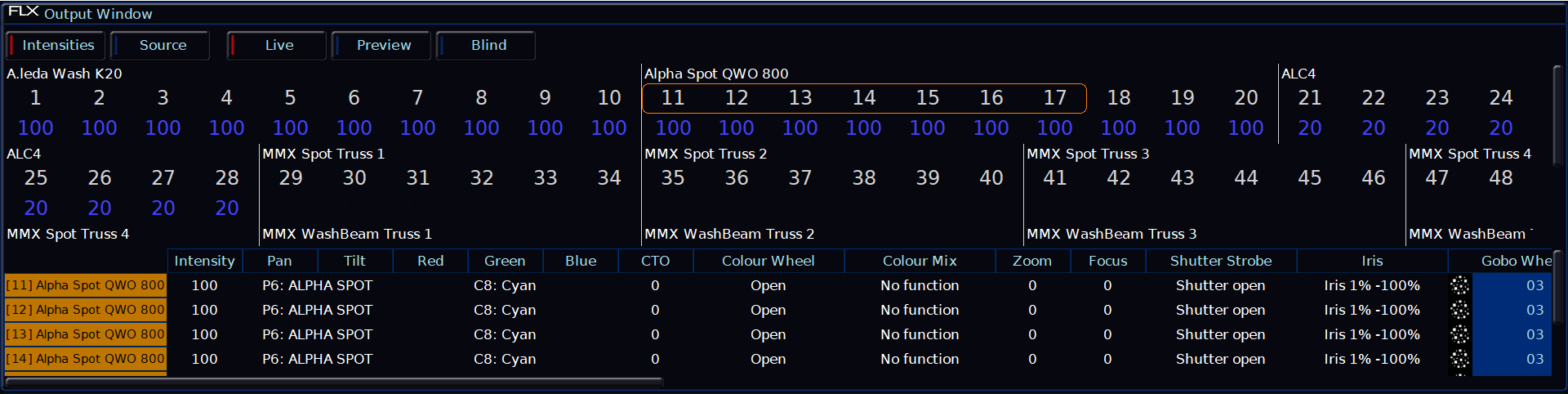

FLX S 48 - colours of intensity values in Output Window
Davidmk replied to DRP's topic in FLX S24 & FLX S48
I may have it off by default, can't remember. I'll look at that as well. As I said it's been working the way I want for ages but I'd like to understand it better. -
Well that's definitely not what I want so perhaps I need to check this out. What I'm trying to do is have a playback that is just colours and control intensity on faders. The colour cues are triggered, out of sequence, using midi. I've been doing this successfully for months but I was making changes to the cues and adding effects to the stack. Another thing to check out. I'm in the theatre for the next 3 days so I can use a real rig instead of Capture. Thanks for the input though. -
Hmm, yes except I didn't turn them on in the programmer. I have sub masters for the intensities. I just assumed that the rainbow effect was colour and intensity and that was where the purple intensity value came from. I'll have to look later. Not important, just curious. -
Just so happens I had purple intensity values myself this evening. I don't normally use cue stacks, much less blocking cues, but it happens that I had added a rainbow effect to a stack of cues and the purple values came up when it was running so, I'm guessing, that an effect cue operates like a blocking cue. Am I right? -
