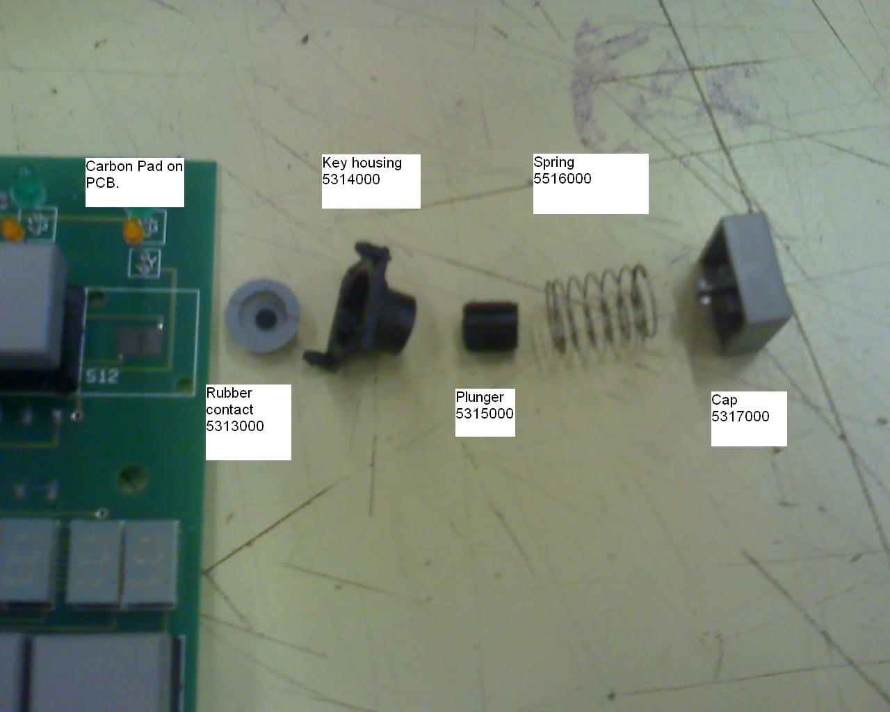

  18. The buttons on the XL are constructed of 6 separate parts. 5 of the parts are used to make up the mechanical section of the switch, the 6th part is actually a carbon pad on the PCB. Have a look at the attached picture. The normal cause of buttons not working correctly is wear/accumulated dirt on the carbon pad or the rubber contact. If you are careful you can wipe the pads clean with a cotton bud, soaked with a small amount of switch cleaner.
