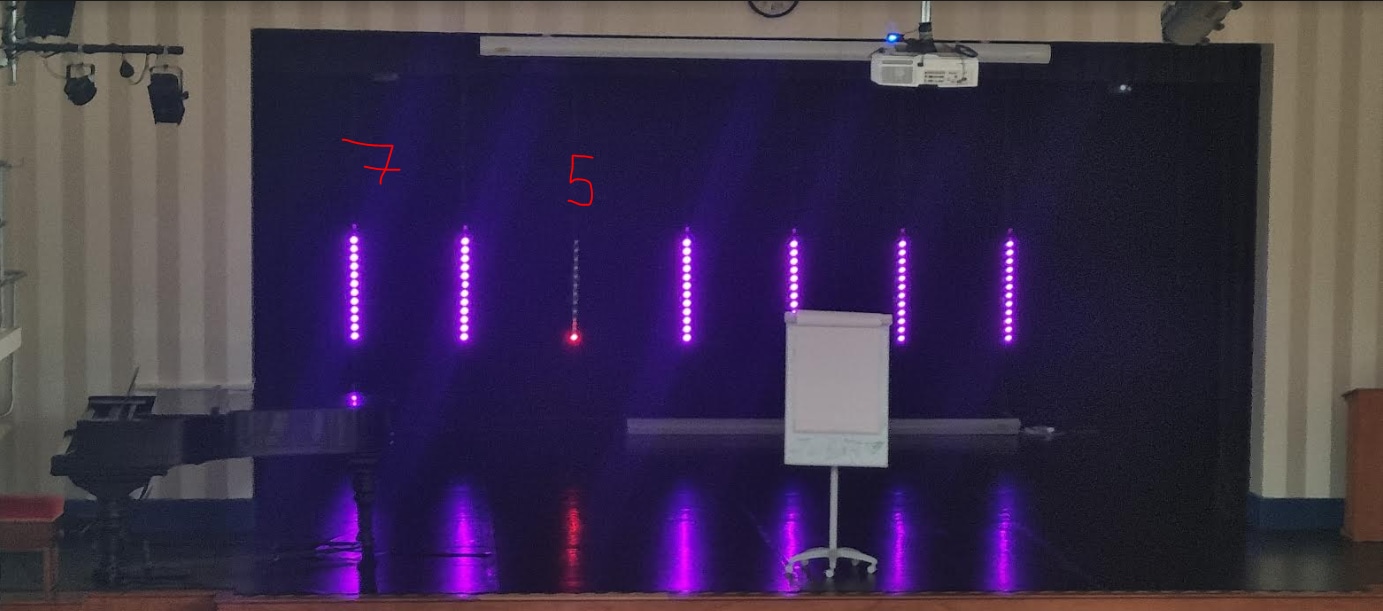

Paul Bennett 211 Posted March 2, 2022 Report Posted March 2, 2022 Hello We are using a Zero88 and have come across a strange issue. I will try my best to explain but i am fairly new to using this hardware. We are running multiple lights, we have 6 LED batons and trying to control the colours this worked perfectly before, we could select all batons and then select a colour. However when we do this now baton number 3 turns a separate colour to the rest. We have restored the desk from an old backup that was fine incase someone had messed with the programming, this did not fix the issue. When we select the baton individually and then select red we get green, It seems like the touch screen is using the button below where we press to select the colour but only on this one light. If you press above the colour on the row above then you get the colour below for some strange reason. But only on that one light What could be the issue, where can i start? Any help appreciated. Please let me know if you need anymore information.

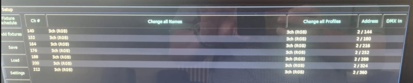

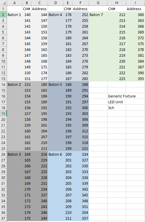

Paul Bennett 211 Posted March 3, 2022 Author Report Posted March 3, 2022 Had a look through the baton setup this all looks ok to me. each "bulb" has a fixture (CH#) and the DMX Address is +3 each time Still scratching my head...
Edward Z88 Posted March 3, 2022 Report Posted March 3, 2022 Hi Paul, 51 minutes ago, Paul Bennett 211 said: Noticed that our batons have been setup using Generic LED 3 Channel RGB. It's always been like this and worked fine so not sure about that. What I find confusing is there are 12 "bulbs" on the baton so each one is its own separate 3Ch fixture.. Very confusing. This is the method that used to be used to control LED battens, where each "cell" was patched as a separate fixture. This is no longer required in the latest software for FLX consoles, as each batten can be patched as a single fixture. If you would like to look at updating your console's software, and re-patching the individual cells as battens, please send us an email to support@zero88.com, and we can advise. 49 minutes ago, Paul Bennett 211 said: We are taking a USB backup of the desk but does this backup the fixtures? Does not look like it. Seems to only backup the programming. When you save your show file to a USB drive, absolutely all settings, patching and programming will be saved. See the link below for more information... https://zero88.com/manuals/zeros/setup/save 50 minutes ago, Paul Bennett 211 said: I also noticed yesterday that this was all setup without using RDM. I am wondering what would happen if i deleted the baton then run the rigsync? Would this screw up everything? In one very unhelpful word: "potentially". If your battens have RDM, and RDM that is implemented well, then it'll work absolutely fine. If they don't, it won't, so I'd suggest sticking with manual patching for now. Please see the link below for more information on RigSync... https://zero88.com/manuals/zeros/setup/universes/remote-device-management 5 minutes ago, Paul Bennett 211 said: Had a look through the baton setup this all looks ok to me. each "bulb" has a fixture (CH#) and the DMX Address is +3 each time Thank you for sharing a spreadsheet. This confirms that your battens should be in 36-channel mode, to work correctly with your console. They will need to have the following start addresses: Batten 1 - 144 Batten 2 - 180 Batten 3 - 216 Batten 4 - 252 Batten 5 - 288 Batten 6 - 324 Batten 7 - 360 Please check the battens are configured correctly, to match the patch on the console. Hope this helps, Edward Edward Smith Formerly: Zero 88 Product Specialist - Email Support Currently: Obsidian Control Systems Product Specialist
Paul Bennett 211 Posted March 3, 2022 Author Report Posted March 3, 2022 28 minutes ago, Edward Z88 said: Hi Paul, This is the method that used to be used to control LED battens, where each "cell" was patched as a separate fixture. This is no longer required in the latest software for FLX consoles, as each batten can be patched as a single fixture. If you would like to look at updating your console's software, and re-patching the individual cells as battens, please send us an email to support@zero88.com, and we can advise. When you save your show file to a USB drive, absolutely all settings, patching and programming will be saved. See the link below for more information... https://zero88.com/manuals/zeros/setup/save In one very unhelpful word: "potentially". If your battens have RDM, and RDM that is implemented well, then it'll work absolutely fine. If they don't, it won't, so I'd suggest sticking with manual patching for now. Please see the link below for more information on RigSync... https://zero88.com/manuals/zeros/setup/universes/remote-device-management Thank you for sharing a spreadsheet. This confirms that your battens should be in 36-channel mode, to work correctly with your console. They will need to have the following start addresses: Batten 1 - 144 Batten 2 - 180 Batten 3 - 216 Batten 4 - 252 Batten 5 - 288 Batten 6 - 324 Batten 7 - 360 Please check the battens are configured correctly, to match the patch on the console. Hope this helps, Edward Hi Edward Thank you for this. I can confirm that the Battens do start with the correct addresses. Was hoping that one would be wrong solving my issue! If we upgrade the firmware then will all the fixtures and addresses be lost? Do we have to patch them all again. With the saving of the file i am slightly confused, after reading the link do we need to use the csv file to be able to save all fixtures and DMX settings? Saving the show file just saves the programming for the lights?

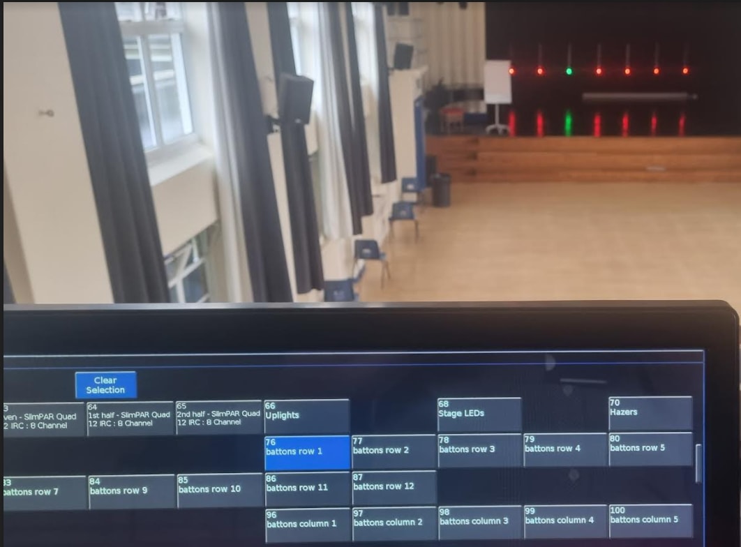

Paul Bennett 211 Posted March 3, 2022 Author Report Posted March 3, 2022 Here is the settings for the group we setup which controls row one of all Battens. As you can see the addresses are correct However when selecting this and picking colour red @10 percent we get this error on batten 5. It's almost like for some reason its picking the colour below from the palette. Select red its green. Select yellow its blue etc. Strangely though white is fine! Any suggestions on what i can do to fix this. I am wondering now if the light is faulty... Thanks again for all your help.

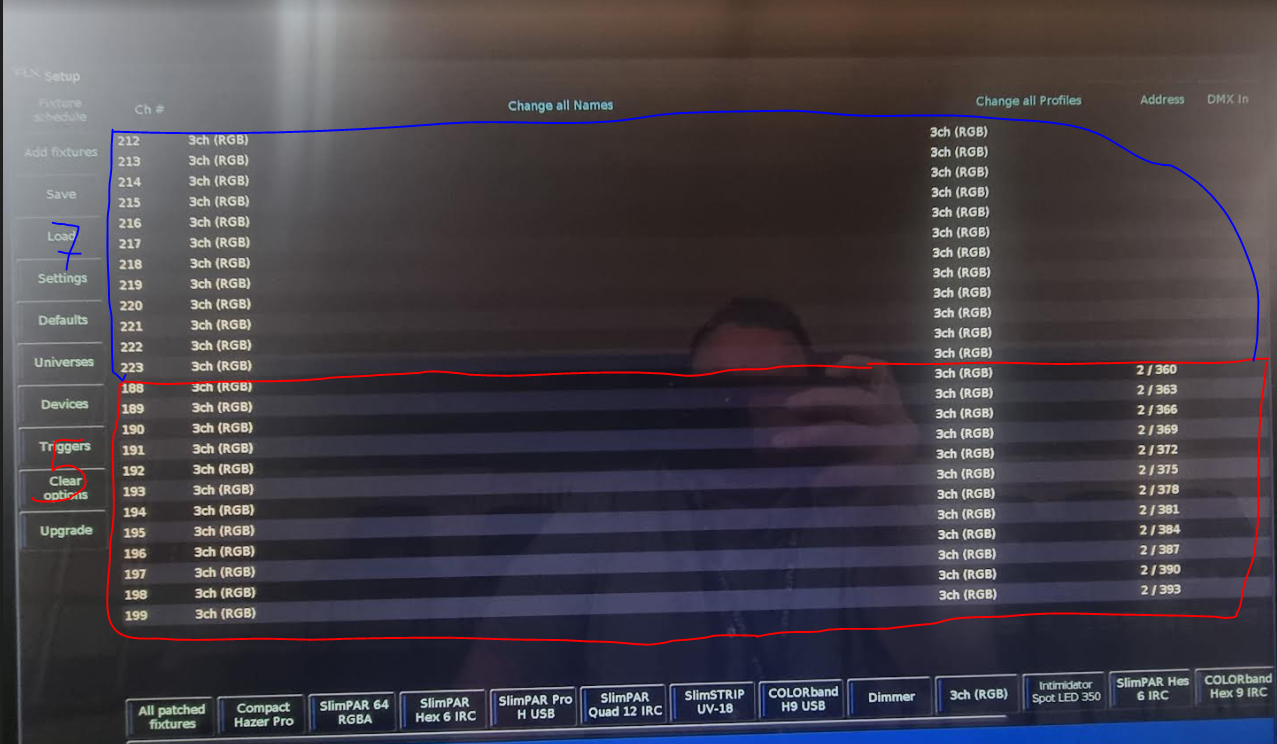

Paul Bennett 211 Posted March 3, 2022 Author Report Posted March 3, 2022 Right i just give batten 5 the DMX addresses of batten 7. This removed the addresses from batton 7 but batton 5 does not work. Strangly when selecting all battens and blue. I now get 1 red on batten 5!!!!! Or have i done this wrong?
Davidmk Posted March 3, 2022 Report Posted March 3, 2022 47 minutes ago, Edward Z88 said: readdress the "faulty" LED batten, to match the start address of a batten that is working Absolutely it is OK to have two identical fixtures with the same address - as long as you want both fixtures to do the same thing at all times. 2 x FLX with Raspberry Pi's running TouchOSC, ZerOS Wing, Leapfrog, Jester M24L Eurolite ArtNet/sACN nodes. Regular tech in two Milton Keynes music venues plus occasional festival work.
Paul Bennett 211 Posted March 3, 2022 Author Report Posted March 3, 2022 14 minutes ago, Davidmk said: Absolutely it is OK to have two identical fixtures with the same address - as long as you want both fixtures to do the same thing at all times. The system told me I was giving it the address of a fixture but I selected patch anyway and now the addresses on batten 7 have gone so it only allows me to have one?
Davidmk Posted March 3, 2022 Report Posted March 3, 2022 4 minutes ago, Paul Bennett 211 said: have i done this wrong? I think you have. It looks to me as if you've made the address changes on the desk - what @Edward Z88 meant was to change the address on the fixture and leave the desk alone. In this case the desk only "sees" one fixture but both fixtures should behave the same. 1 2 x FLX with Raspberry Pi's running TouchOSC, ZerOS Wing, Leapfrog, Jester M24L Eurolite ArtNet/sACN nodes. Regular tech in two Milton Keynes music venues plus occasional festival work.

Paul Bennett 211 Posted March 3, 2022 Author Report Posted March 3, 2022 @Davidmk Thank you. Made some progress lol. I gave batten 5 the same number as batten 6. Now 5 goes to the correct colour the issue has moved to batten 6 ha ha What is strange is they are not behaving the same... The issue is now batten 6 even though it has the same starting address as batten 5 (d324)
