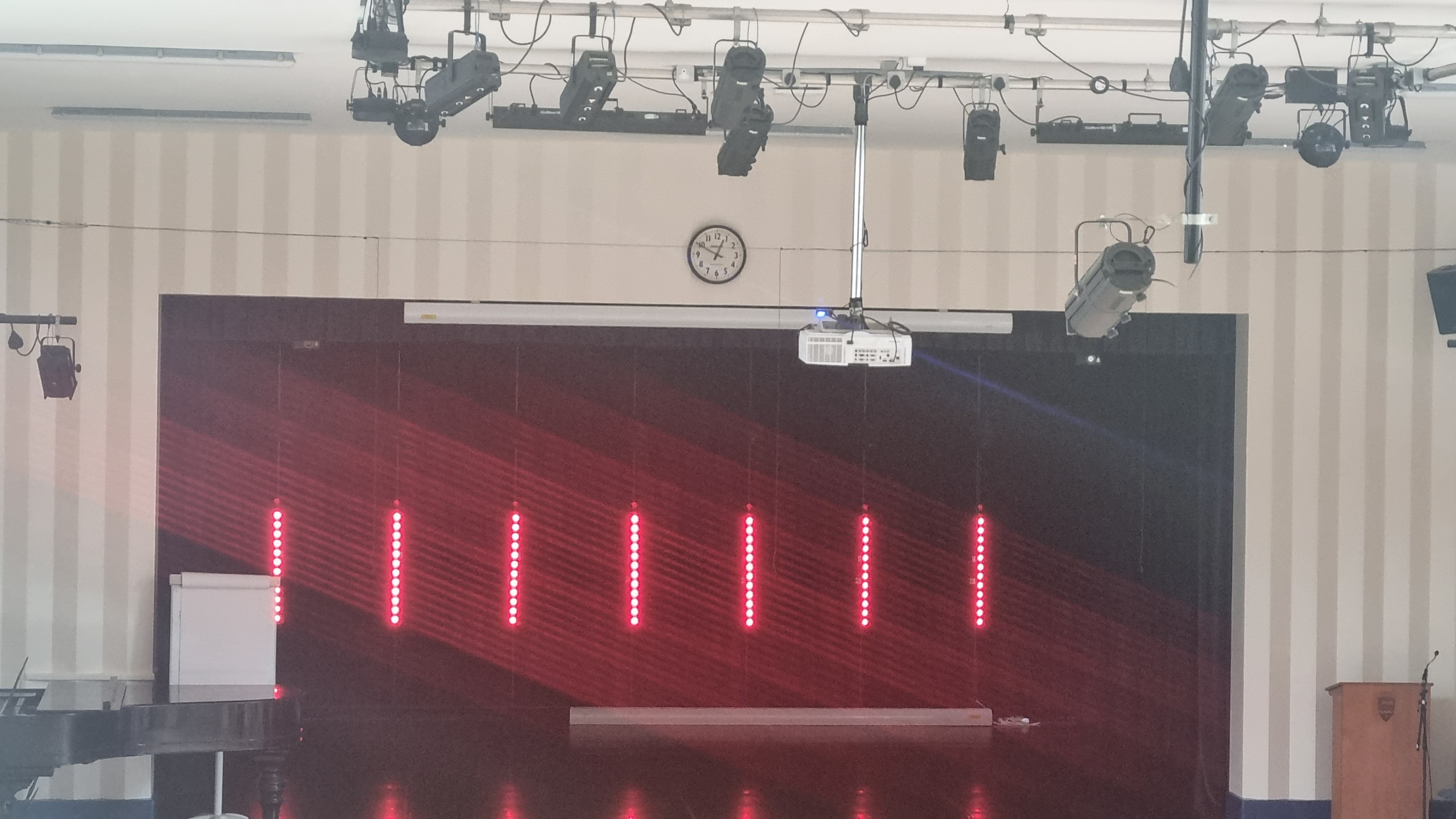

If, as you claim, 5 & 6 have the same starting address, are both in 36ch mode and neither is faulty then this should not happen.
Bit of a long shot this but take the DMX line from your desk direct to fixture 5 and unplug 7 from 6. If you have a DMX terminator plug it into the DMX out of fixture 6.
We are looking for a bad DMX connection here. If there's no change take the feed from the desk to 6 and connect 5 to the DMX output on 6. Move the terminator to 5
(If you don't have a DMX terminator then get a couple, they are fairly cheap on ebay/amazon. Put them in your toolbox and always try them first if things don't behave as expected.)
I made a mistake. The dmx number on batten 6 was different don't know what I did there...
Now 5 and 6 are the same it is treating it as the same light. All colours are fine..  I also checked all lights and they are in 36 channel mode..
On a different note. Why are the fixtures set to 36 channels but I only have 3 dmx address? Does that matter?
So what can be my issue? Ruled out a faulty fixture..
The address on the fixture is the first address that fixture uses. On the desk it has been patched as 12 fixtures of 3 channels each. This is perfectly OK. If you had an FLX S desk you'd be in trouble as those desks are limited to 24 or 48 fixtures but a full FLX desk has no restriction on number of fixtures only on DMX channels.
Glad you've got to the bottom of this. Hopefully you've learned some stuff about DMX now which will help when you run into your next patching issue.

OK that makes sense.  Nice one.
I have not fixed the issue though. I have batten 5 and 6 working as 1 light. But still have the issue if I change the address back..  So where should I look now to resolve this.
Thanks for the help with this
Posted (edited)
Fair point. We've established that the fixture works correctly with one starting address so it should be OK with any starting address. So, set it to the correct address (making certain that it is in 36ch mode) and make sure that the address of the first cell in this group on the desk is the same and see if it is OK now - it should be if you've got addresses and modes correct.

Just put the batten 5 back to its starting number of 288 and it works!!!!
Thank you all so much,  Must have just been a wrong number on one of the fixtures but without knowing what to look for its had to diagnose.  Learnt quite a bit over the last couple of days about DMX so will continue watching the videos.
thanks again.
