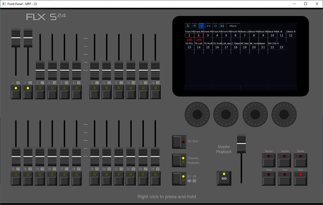

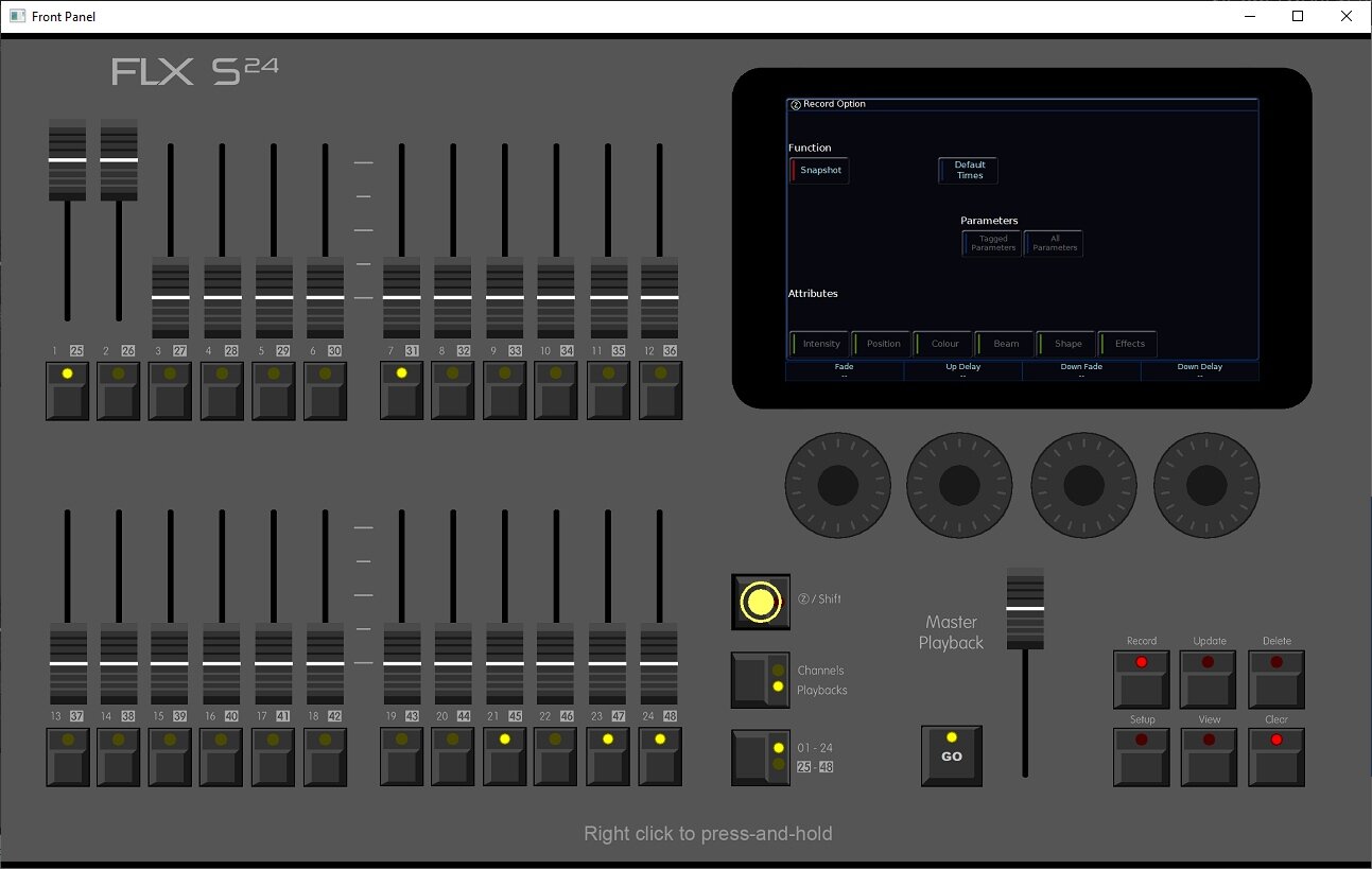

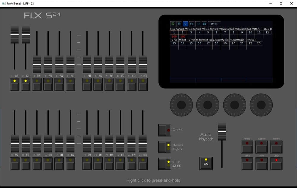

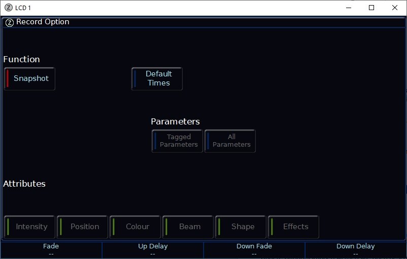

Holger Posted April 20, 2022 Author Report Posted April 20, 2022 Thanks, I tried the first suggestion on Phantom but failed: 1) I selected my scene (Channels 1 and 2 100%) -> A01_SelectScene.jpg 2) Then I hold shift and clicked Record -> A02_AfterShiftHoldAndRecord.jpg (In real the not illuminated playbacks are blinking) and A02_TouchScreen.jpg Now, you see the touchpad - how can I select an empty palette in the touchscreen?
Edward Z88 Posted April 20, 2022 Report Posted April 20, 2022 Hi @Holger Thank you very much for sharing screenshots of Phantom ZerOS. If the Record Options window is opening as soon as you press RECORD, this means the window settings have been changed. To access the Record window settings, tap SETUP -> Settings, and scroll down to the bottom. It sounds like your console is set to "Internal Display", meaning the window opens as soon as Record is tapped. By default, "External Display" will be selected. This means the window will always appear on an external remote display, but can be opened internally if you press and hold RECORD. Please set this option back to "External Display", to allow you to record palettes. You can then tap SETUP to save and exit Setup. You will then be able to hold SHIFT and tap RECORD, and the Record Options window shouldn't open. If you only have dimmer channels selected, you will need to record your Snapshot palettes into Effect palettes, as you will not be able to access the other attribute tabs. I hope this helps. If you have any questions, please let us know. Edward Edward Smith Formerly: Zero 88 Product Specialist - Email Support Currently: Obsidian Control Systems Product Specialist
Holger Posted April 20, 2022 Author Report Posted April 20, 2022 Thanks a lot! Yes, when I tap "Effects" I can select a plaette. And it seems to work in my test case. I will try to use it in more details - and I suppose I'll have further questions.... Thanks a lot so far!!
