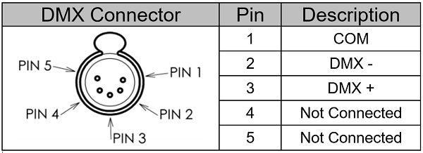

DMX Outputs
Gateway 4 can output a maximum of four Universes of DMX512 data. There are four DMX/RDM output ports with female XLR5 connectors.
If network data or connectivity is lost, the device will hold last state.
