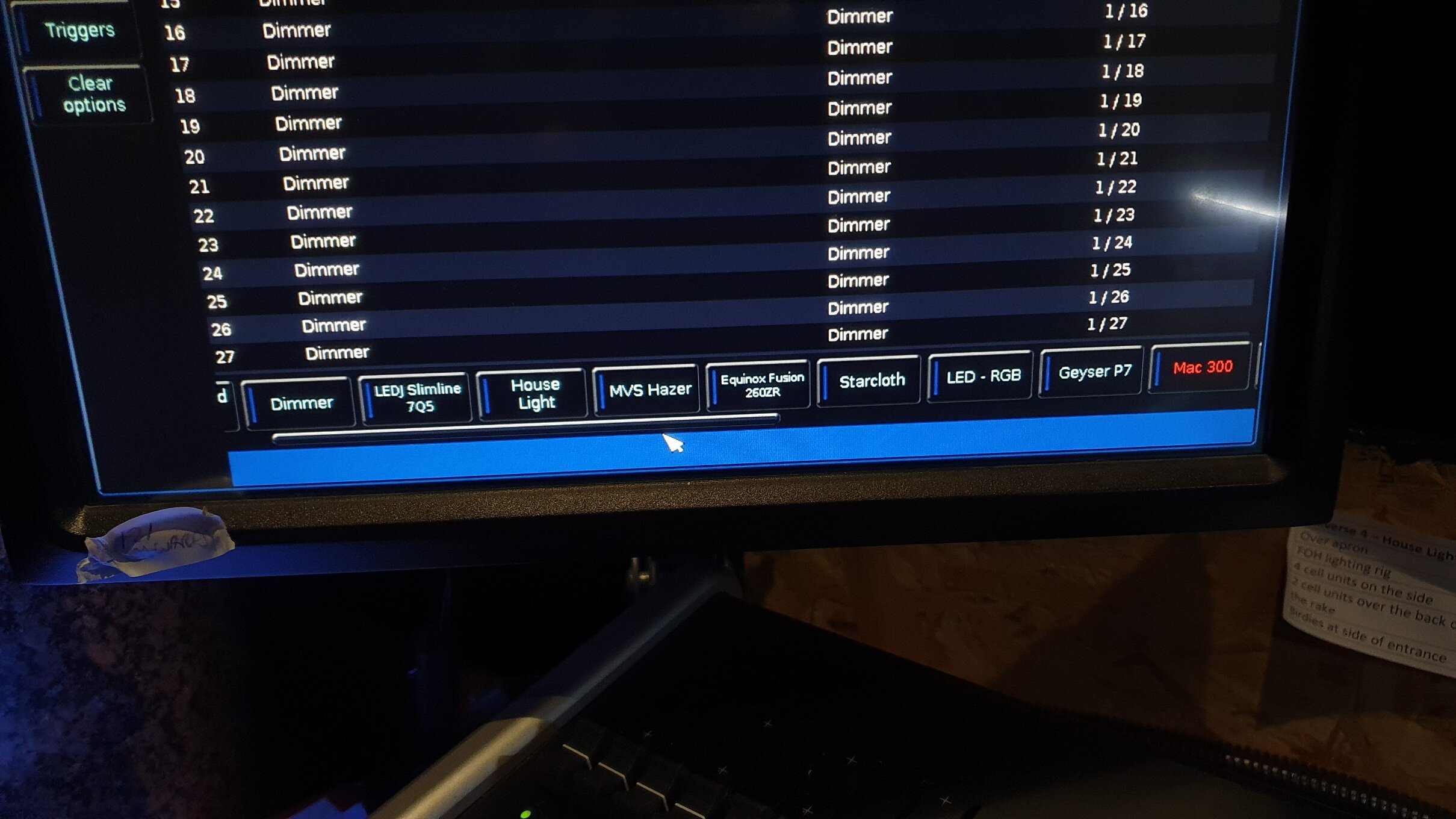

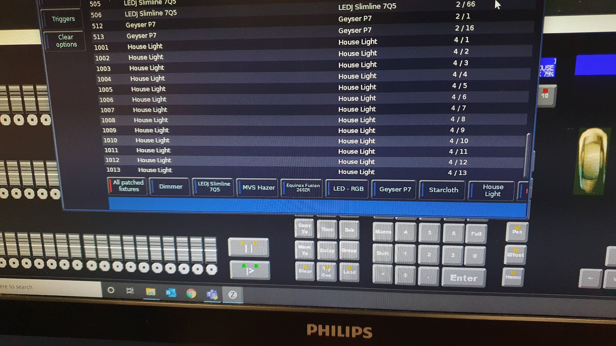

  8. Hi All, Now the busy period is out the way we're looking to make the move to Zeros 7.10. I've done some testing on phantom before going to the live desk and noticed when trying to update fixture profile groups on phantom 7.10 the fixture schedule is missing the slider (pic 1) Compared to 7.9 on our live desk (pic 2). Can anyone with an ORB confirm if this is like this on the live desk after updating? Also genuinely are there any Orb related bugs for 7.10 that have been flagged? Many thanks Steve.
