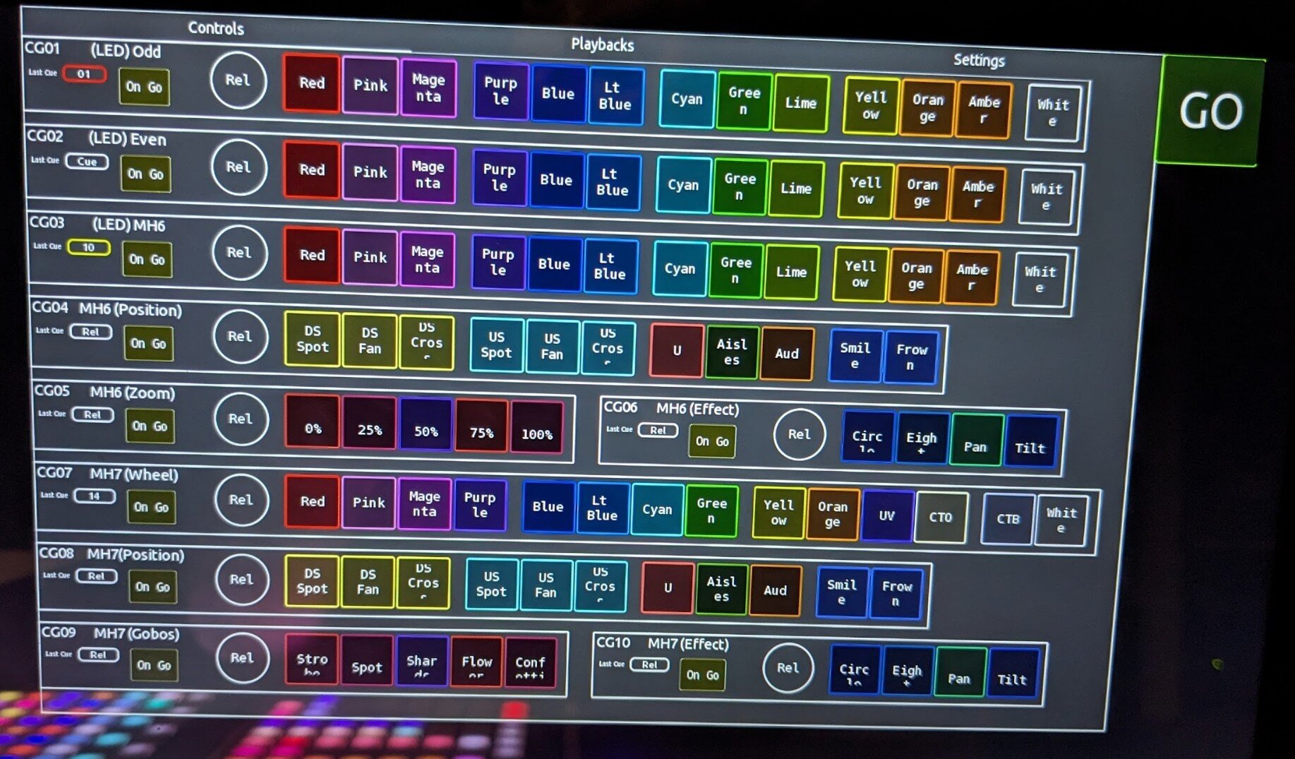

Looking at the view of PB25 he's triggering cues within PBs. That edit window refers to the button which has triggered cue 25/3 (cue 3 in PB25). I'm more interested in the edit window itself, this doesn't look like touch OSC so, what are you using @Tomas Pokorny?
