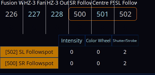

Charlie Newman Posted November 17, 2024 Report Posted November 17, 2024 So I recently created a custom fixture and set the default value on the strobe channel to 5, but it shows as two on the light when selected? No playbacks or cues are overriding it so I'm quite lost, any help would be appreciated

Davidmk Posted November 17, 2024 Report Posted November 17, 2024 @kgallen @Charlie Newman Hmm. A DMX value of 5 (out of 255) is pretty much 2 and I think the fixture profile works in DMX value while the display works in %. If in doubt check the manual and/or the DMX output window. 2 2 x FLX with Raspberry Pi's running TouchOSC, ZerOS Wing, Leapfrog, Jester M24L Eurolite ArtNet/sACN nodes. Regular tech in two Milton Keynes music venues plus occasional festival work.

Charlie Newman Posted November 17, 2024 Author Report Posted November 17, 2024 5 minutes ago, Davidmk said: Hmm. A DMX value of 5 (out of 255) is pretty much 2 and I think the fixture profile works in DMX value while the display works in %. If in doubt check the manual and/or the DMX output window. Ah yeah, that would make sense, thanks!

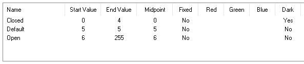

kgallen Posted November 17, 2024 Report Posted November 17, 2024 OK give this a bash. On channel 3, I've added detail (which I made up). 0-4 is "Closed", 5 is "Default", 6-255 is "Open". Ch1 default (Dimmer [Intensity])=255, Ch2 (Wheel [Colour])default=0, Ch3 (Strobe [Beamshape])default=5 These are the "Details" for ch3: Let's see what comes up for the Strobe channel by default... Put this on a USB stick and just use "Load" to get it in the desk. Then you'll have to patch, Manufacturer="Charlie", Fixture="Followspot 3ch" Charlie_FS.ift 1
Charlie Newman Posted November 17, 2024 Author Report Posted November 17, 2024 Yup @kgallen, works like the other one (other than showing when closed/open), interesting that shows in %, personally I'd rather 1-255. Thanks for the help!

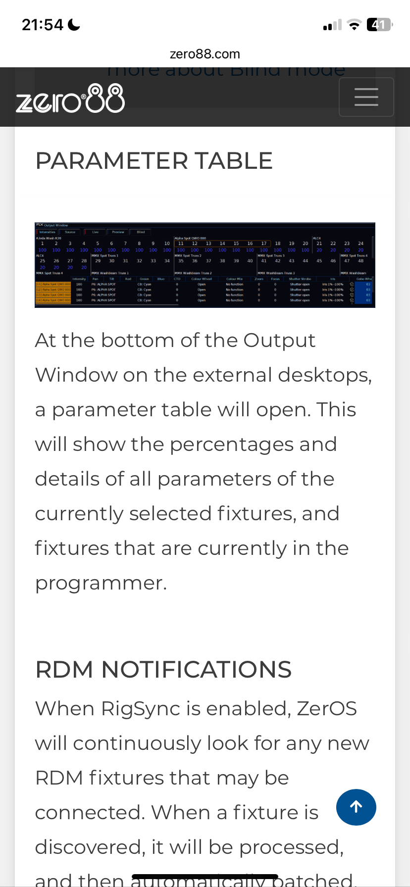

kgallen Posted November 17, 2024 Report Posted November 17, 2024 Well, wadaya know… ’percentages’ https://www.zero88.com/manuals/zeros/desktops-windows/output-window
kgallen Posted November 17, 2024 Report Posted November 17, 2024 Looks like we were talking about it here: So the numbers on the encoder wheel are the raw value but the output window and any syntax uses percentage. Ok, that’s me all confused now!
