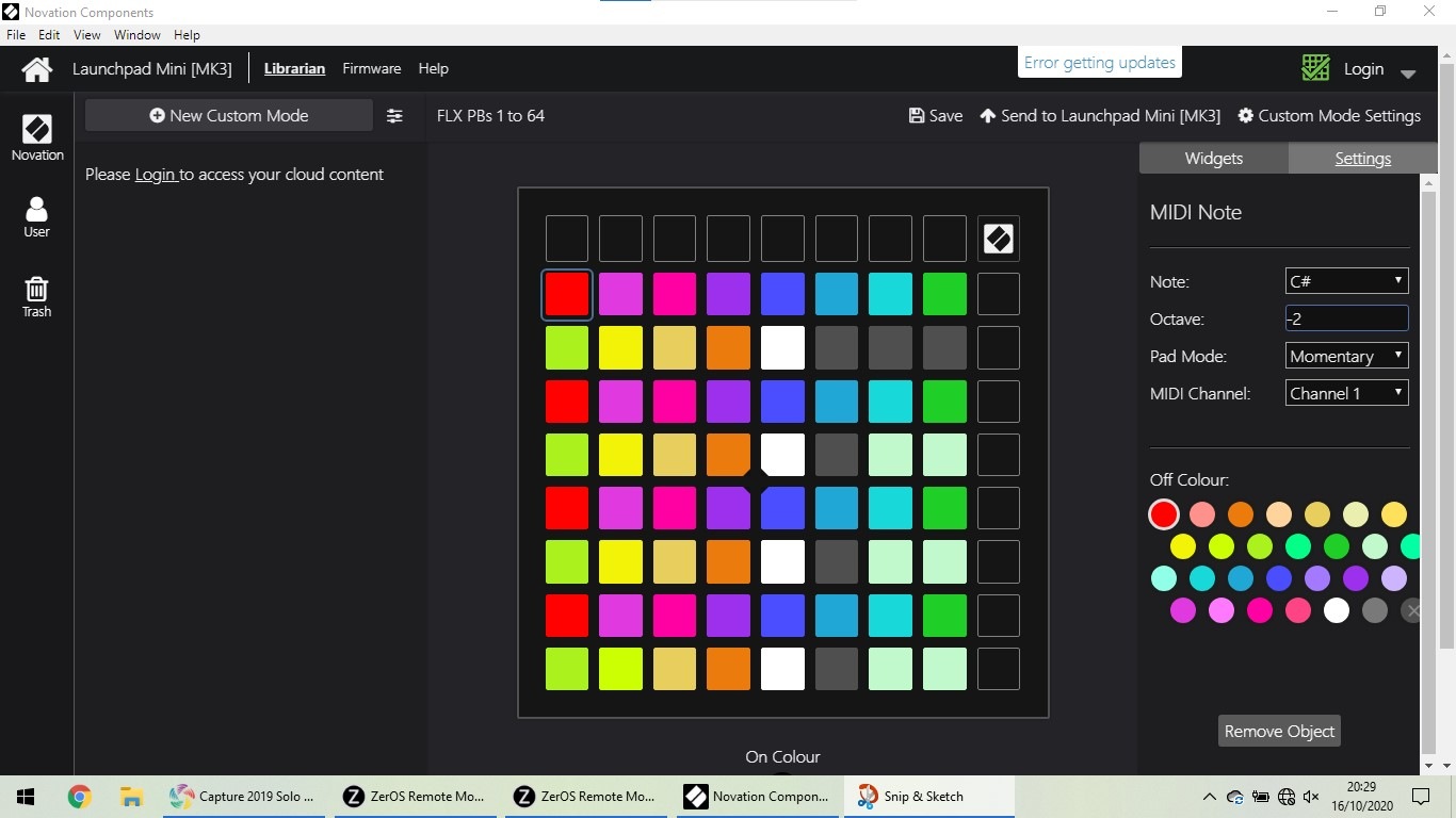

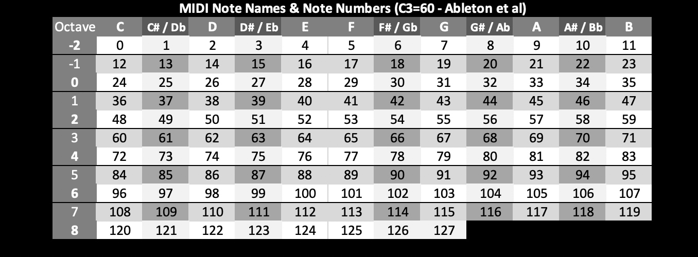

115839602_MIDINoteNumbersNames1.thumb.png.41ce8e9c6abb2eeef5ecd61e0e8aa587.pngHi David,
I was simply going by the info in the pix.
Components - shows top left button = PB1 with Note value of C# and Octave value of -2.
But according to the midi notes chart the first midi note is 0 (Zero) and value is C and Octave value of -2.
For me I tested this and my PB1 is now triggering fine.  I even downloaded your file again to ensure I had not loaded a file that I had been messing around with.

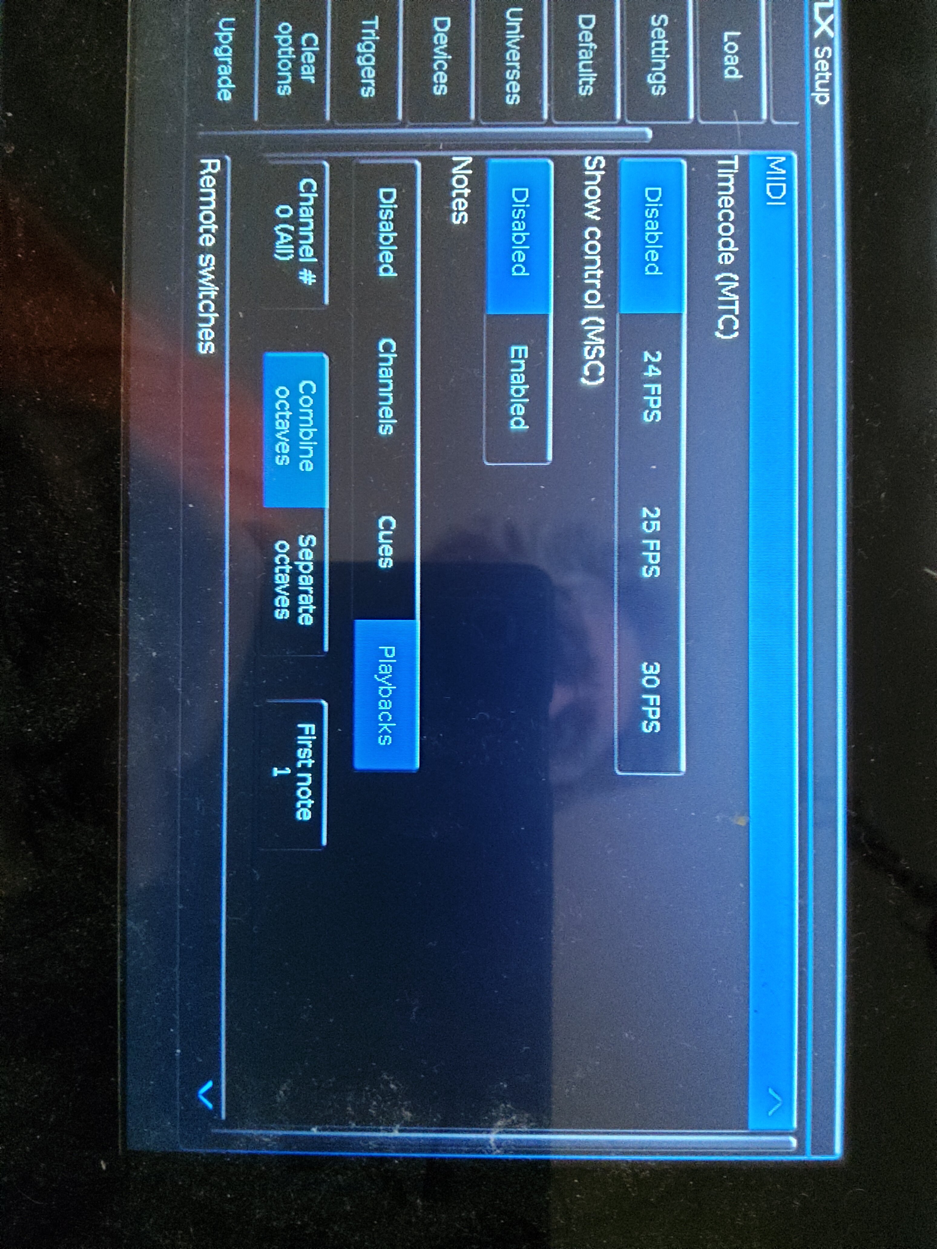

2 hours ago, Davidmk said:
I've got the same for the first button but it fires pb1 not two. Edward said midi 0 would fire pb1 and you said midi 1 was firing pb2 1 if that is true then my desk must be operating in a parallel universe (or, being 2 versions behind is making the difference).
I reckon I have worked out where the confusion may be. If you tap SETUP -> Triggers -> Combine Octaves, what is your “First Note” set to? By default, this should be 0. This will mean in Channels, a Note 1 triggers fixture 1, in Cues Note 1 triggers cue 1, and in Playbacks Note 0 triggers playback 1. If you have the First Note set to 1, and then click Separate Octaves, in Playbacks Note 1 will trigger playback 1. Note 0 will have no function.
Could this be what you’re seeing?
If so, to save @Uriahdemon remapping all the Novation buttons, you can tap Combine Octaves, change the First Note to 1, and then click Separate Octaves.
Edward
Edward Smith
That was the setting I couldn't find!!!
Why doesn't it show up on separate octaves? Bug, surely
Correct. Unfortunately the “First Note” field is applicable for “Separate Octaves”, however is incorrectly hidden when Separate Octaves is chosen. Logged on our system, to be fixed in a future update. Most people will just live in “Separate Octaves” with the default of the First Note of 0.
Edward
Edward Smith

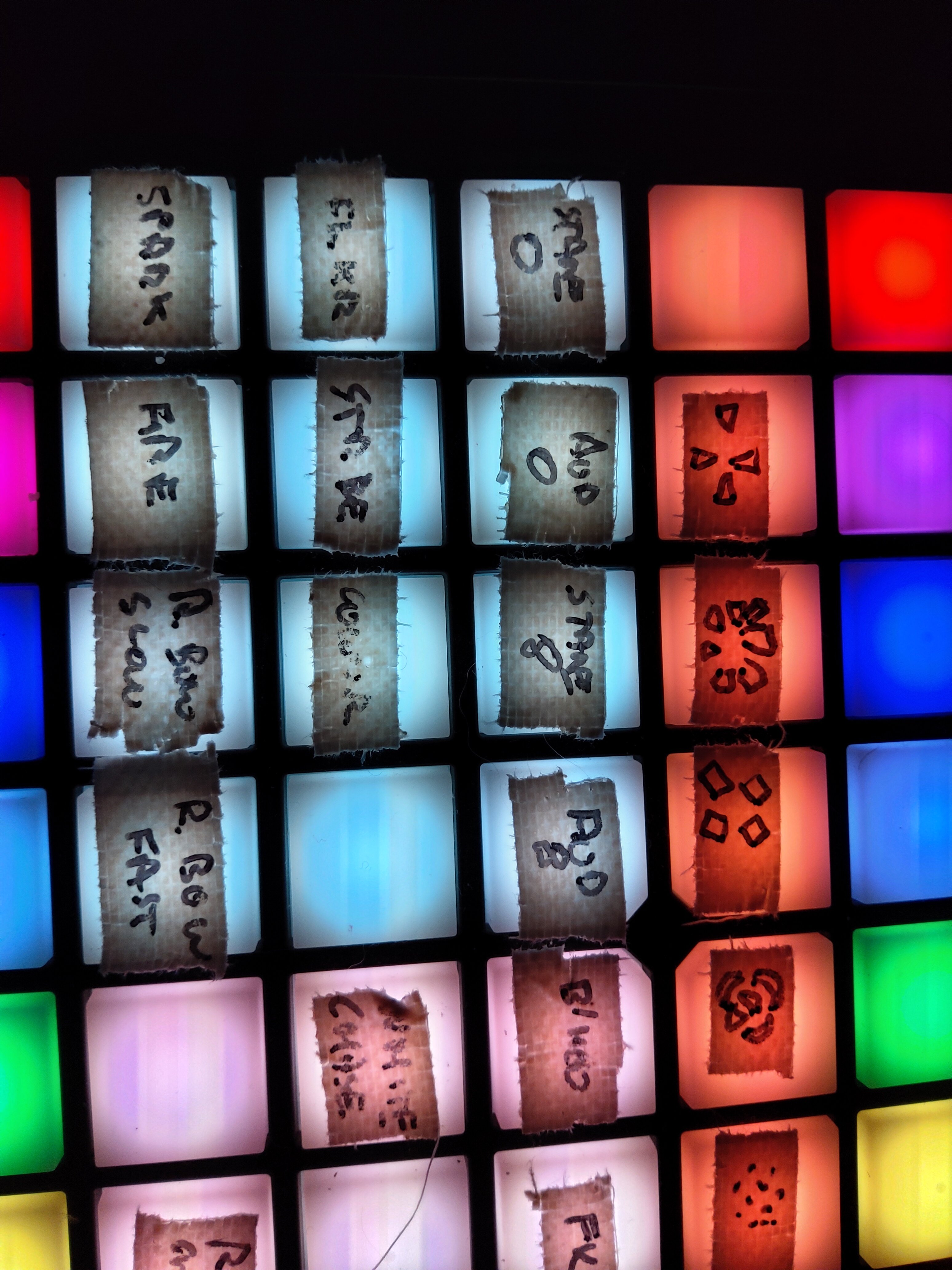

14 minutes ago, Davidmk said:
If you find anything better then please let me know.
Well...  I have just tried the dymo label maker and they will not stick.  The pads have some give in them so the application has to be very thin and very sticky.  I guess it may have to be gaffer
1 hour ago, Uriahdemon said:
dymo label maker
Yep, tried that, and transparent printer labels. Thought about trying sandpaper to give some grip and/or wiping the keys with meths before applying labels. Suppose you could cling film it and put labels on that.
Do they make keyboard protectors (like you get for keyboards or tills in bars) for it?
