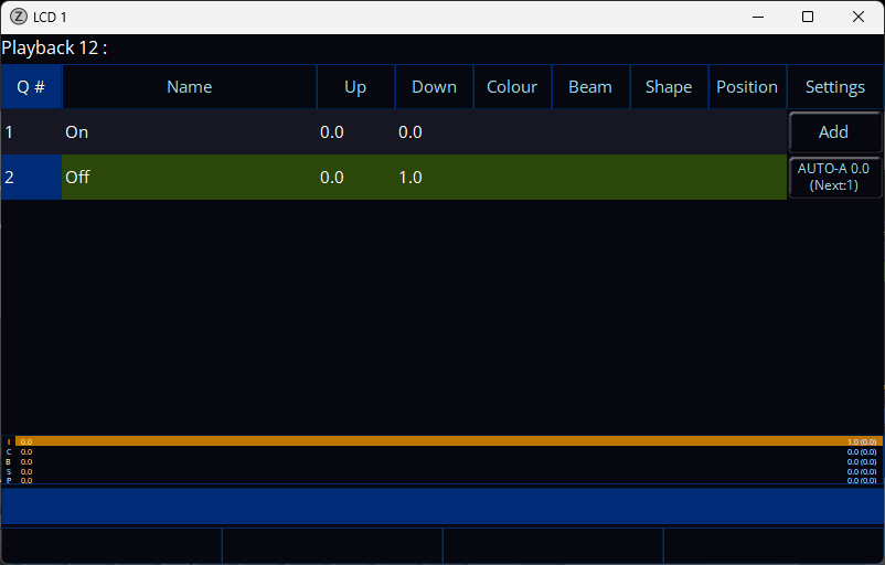

Currently, there's no native way to do this via a flash button. It has been requested before and is logged (reference ZOS-3202) - I've added your comment as an additional request. If you only want to flash (not press-and-hold), you could create two cues - first one snaps on, second one fades out, and then set the second cue to Auto follow. Now, pressing the GO button will snap the light on, then fade it back out. You will need the physical fader to be at full to make this work.
