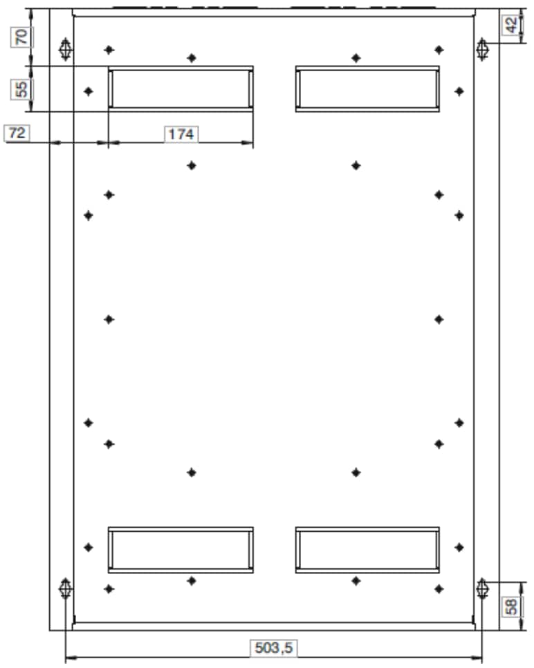

The unit should be installed in a dry ventilated location, where ambient temperature and humidity are within the operating range of the unit.
RigSwitch cabinets are provided with four fixing holes for wall mounting. The mounting holes can be accessed by undoing the screws on the front cover and removing it
Wall drilling positions are shown in the diagram below.
  • RigSwitch 12 cabinets have a height of 450mm (max 18kg)
  • RigSwitch 24 cabinets have a height of 600mm (max 20kg)
Rigswitchrear
