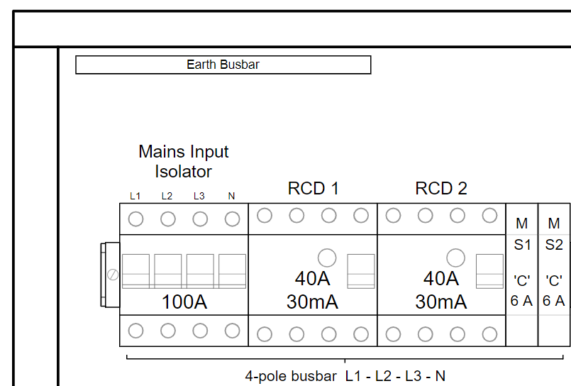

To connect the mains to RigSwitch cabinets, bring in a suitable 3 phase supply at 100A per phase maximum, to the main isolator top left of the cabinet, and a secure mains earth to the Earth busbar at the top of the cabinet. RigSwitch will accept a maximum 35mm2 input supply cable.

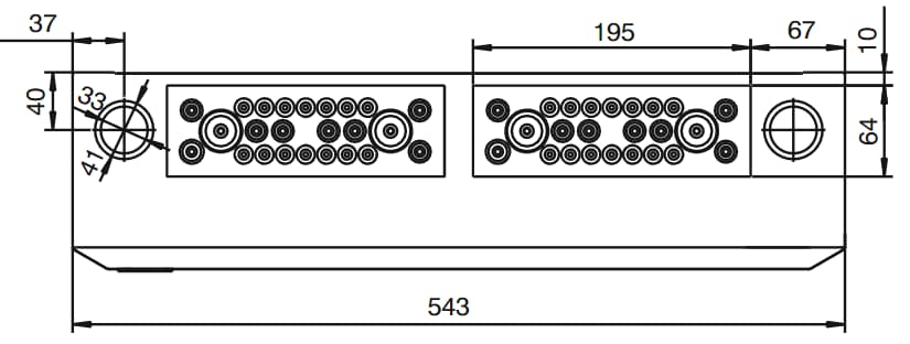

Top Cable Entries
2x Flange:
- 14x ø11mm
- 8x ø15mm
- 2x ø28mm
Relief stamp:
- 2x M32/M40
RCD versions of RigSwitch cannot be operated or powered from a single phase supply.
